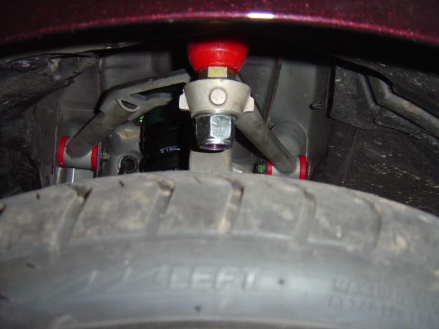

Default A arm
So far so good. I had no problems installing them. I did have a little trouble figuring out which way they are installed but in the end I managed to match them up correctly with the oem arms. I also had to cut out the red boot to allow it to sit better over the ball joint. Other than that, I am satisfied.

I'm not really panning mods where I'll need front camber correction, but I do like the idea of those poly bushings.
ZxRage, thank you off posting that pic.
