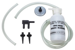

for those of us without friends or relatives that want to press brake pedals... I just picked this up from advance auto parts and it did a very nice job.
http://www.partsamerica.com/PartDeta...egoryCode=3378
