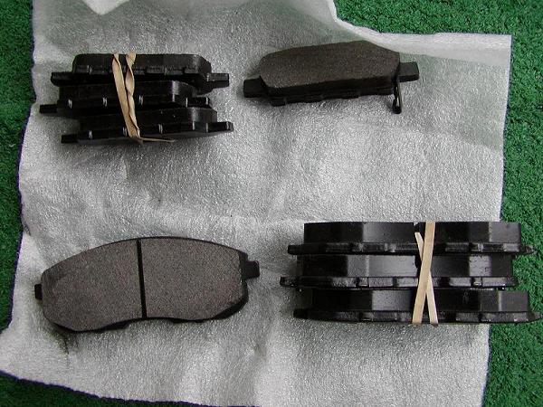

Just got my pads from Tire Rack.... looked a the pads and they are missing metal clips on them.
On the front... Not a single pad has them attached... and 1 is just laying in the box
On the rear... only 1 is attached .. and the other is not there.
ANYONE Installed these pads before. Did you have the same problem? Can these pads be used without the clips.

The clips you're talking about are the audible wear indicators.
You shouldn't have any problem using them without the clips, just keep and eye on your pads.
You also have another option of attaching the extra clip to one of the front pads so you can hear when they start to wear thin. I would go this route.

no ... i think they are called the Caliper clip... If you look on the pic.. You will see the pad in the UPPER RIGHT hand corner.. has it sticking out from the back.
That clip is usually mounts on the inside... where it touches the caliper. So thats why i need to know if it actually holds the pad in place or just there to keep it from wobling around under braking.

jeff is correct. the tab is there as a wear indicator only. the tab will start to hit the rotor before a worn pad will. this gives you an audible alarm as to when you should change your pads, and safety, so you wont damage the rotor. put them on...they are fine.
