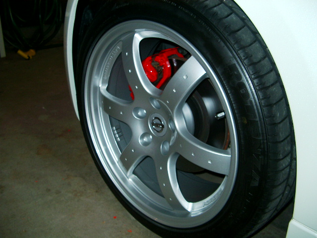

In all seriousness, get the G-2 paint, there's no need to take the calipers off. About a 2-4 hour job.

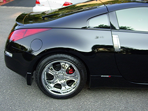

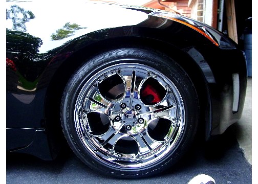

I recommend you paint yourself. Not difficult, 3 hours of time.

Took me 4 hours to clean calipers and hand paint 2 coats.
Calipers stayed on car.

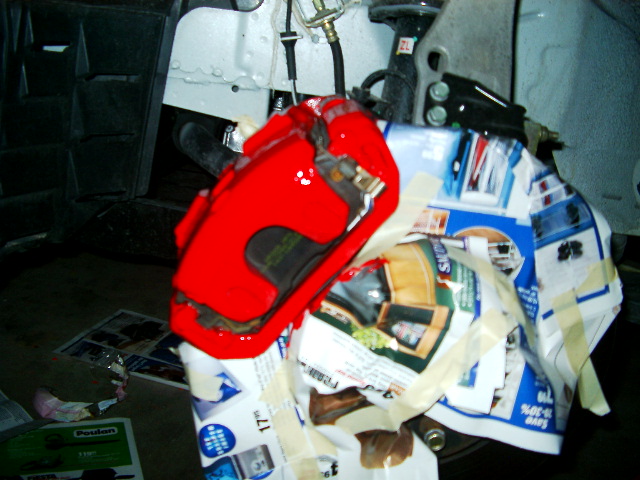

I used a garage jack. Lifted one side off the ground, did two brakes at a time.

I bought Caliper paint at Checkers Auto Parts. I do not remember the name. Cost $15.00. Similar kit like G2
I did two brakes at a time. Did the fist in approx. 1/2 hr., did the second. Went back to the first for second coat. The paint I used stated I could use second coat in 20 minutes.
You can put your wheel on while the second coat is still drying. Your wheel will not (should not) come in contact with the caliper.
I suggest you leave to dry a couple of hours before driving.

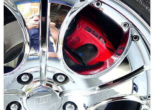

One more PIC

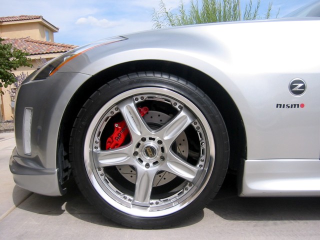

Talk to Paul @ Avalon Racing. He'll get you the best prices on red brakes.
