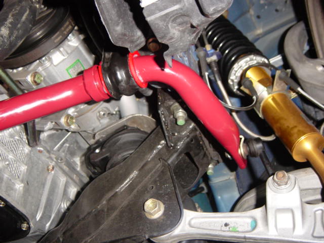

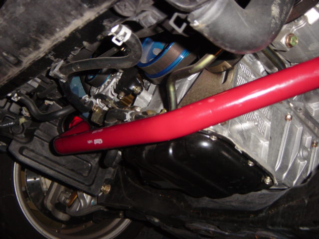

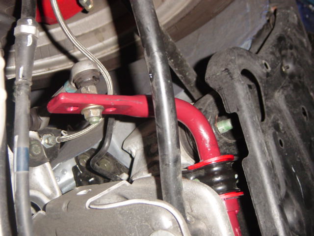

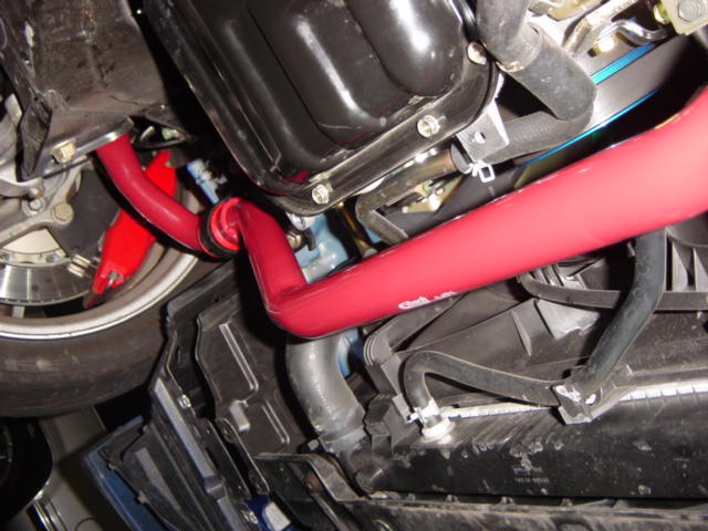

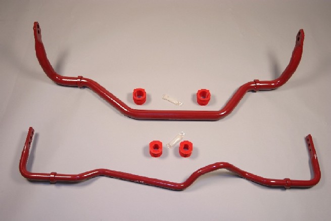

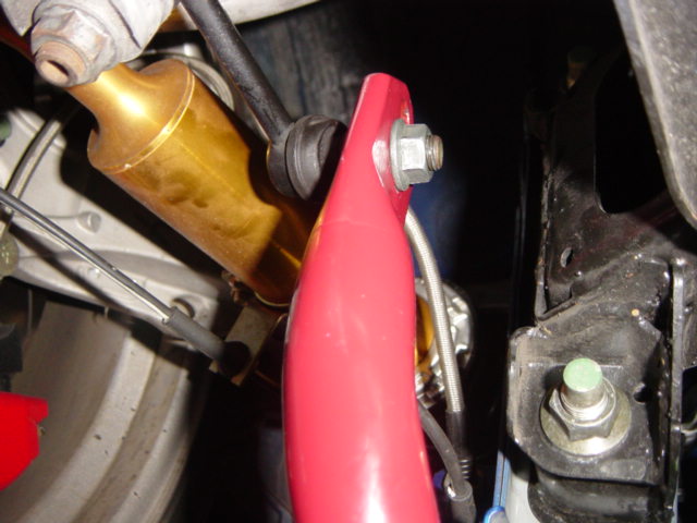

INSTALLATION:

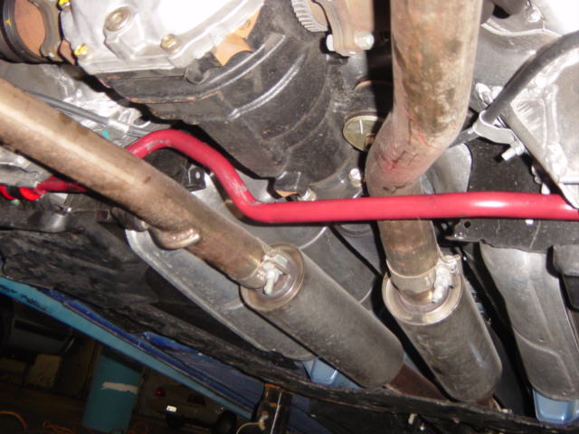

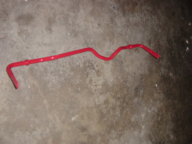

Just got through installing both front and rear Eibach adjustable sway bars. The installation was very easy. The only difficult part was removing and installing the rear bar around the exhuaust. You have to do quite a bit of turning and pulling to get the bar out and back in. I choose not to remove the exhaust piping. I put the front at the stiffest setting, while the rears was set to the middle setting, "street Performance".
QUALITY:
The front bar was slightly thicker than stock, nearly the same weight. The difference in the rear bar was significant. The stock bar was very very light and not very sturdy. The Eibach rear was significantly more sturdy and heavier.
FEEL:
I have not had a chance to really drive the car hard. I could immediatly tell that the front end hugged the corners much better. There is virtually no body roll at all. Much stiffer in the nose.
For the $ a welll worth while install.
Attached Thumbnails EIBACH Sway Bars Installed REVIEW w/ Pics-dsc03075.jpg

Old Nov 22, 2004 | 03:29 PM
maserom's Avatar
maserom
Posts: 511
From: Marina Del Rey CA
pictures
Attached Thumbnails EIBACH Sway Bars Installed REVIEW w/ Pics-305z-sways2.jpg

I've always wondered how the install was on these, doesn't sound like it was too bad. Might have to look into getting some of these at some point
Old Nov 23, 2004 | 07:06 AM
maserom's Avatar
maserom
Posts: 511
It was not bad at all. Very easy, just make sure you have a good 1/2 " drive set with a lot of leverage. The bolts are on there very tight. This mod made more of a difference than i ever expected.
