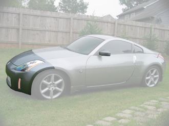

If you want a fit like this, have your man call me.

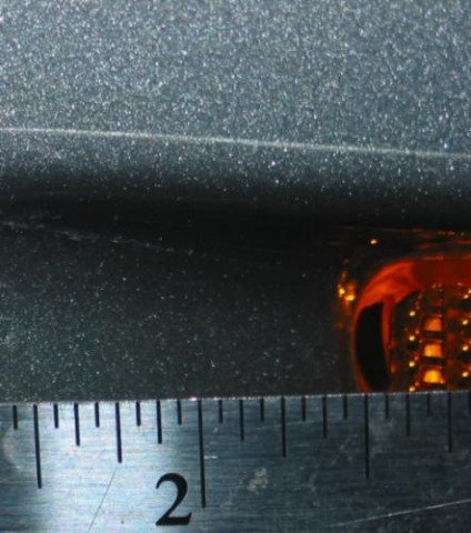

even a close up won't show a bad job. I can play with a polarized filter to get the film to show up better, but is still won't show quality of work. My mirror is also 2 piece. The difference is that it fits better and goes all the way to the edge.

Does this close up show the quality? Very clear in good light and it looks good.

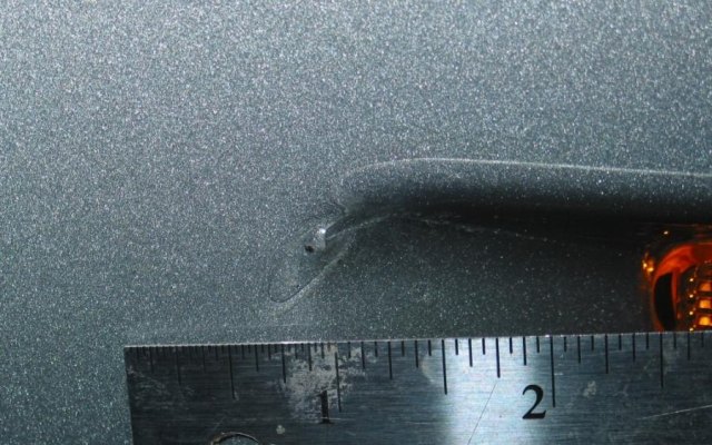

It's easy to cover flaws with close-ups. This is the same spot with the bad area NOT cut.

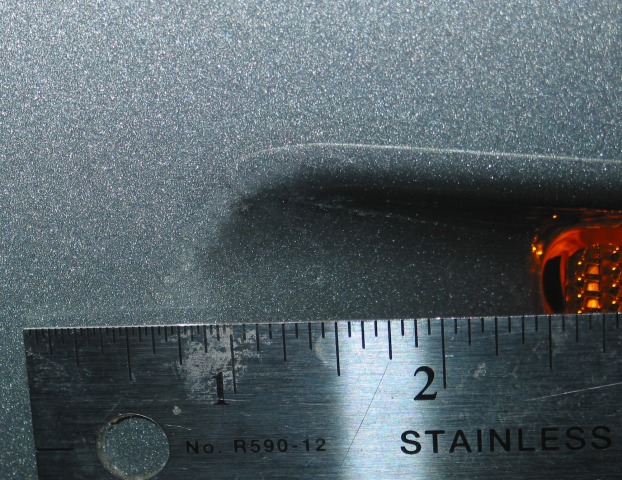

five minutes of photoshop.
I'm just trying to make the point that you shouldn't trust internet pics from anyone. Look at the installers work and judge for yourself.

I'm not exactly sure what you're trying to show here. Does the picture even represent a 350Z section?
You say it's easy to cover up flaws with close ups, but your close up easily shows a 2 pretty bad flaws.
#1 There's a "dog ear" or fold of extra film material from improper placement of a precut pattern. Could be avoided with proper alignment or a small relief cut, no? A free hand cut of the film never looks as good as a precise (factory)precut.
#2 There's a black foreign body trapped under the film.
I agree that wrapping the film around the edge looks much better, especially around the hood. It's also a much EASIER job since you don't have to worry about aligning the edges precisely.
I would say that what makes the precut vs. custom patterns much better is the way they handle the complex cut-out. (i.e. emblems, fog lights,etc). This is what separates the good from the mediocre.
For those with "custom" cut clear bra film, I would really like to see how they handled the "NISSAN" emblem. If someone can precisely cut that opening "freehand," they are very talented.
Dean

I was trying to show that a close up does not show anything. Actually this an XPEL kit on a 350Z at the top of the reflector. The flaw was a tear from an unskilled installer. I took the pics prior to removing the kit for possible use as evidence in small claims. The owner is now happpy with his full-wrap DynaShield kit.
