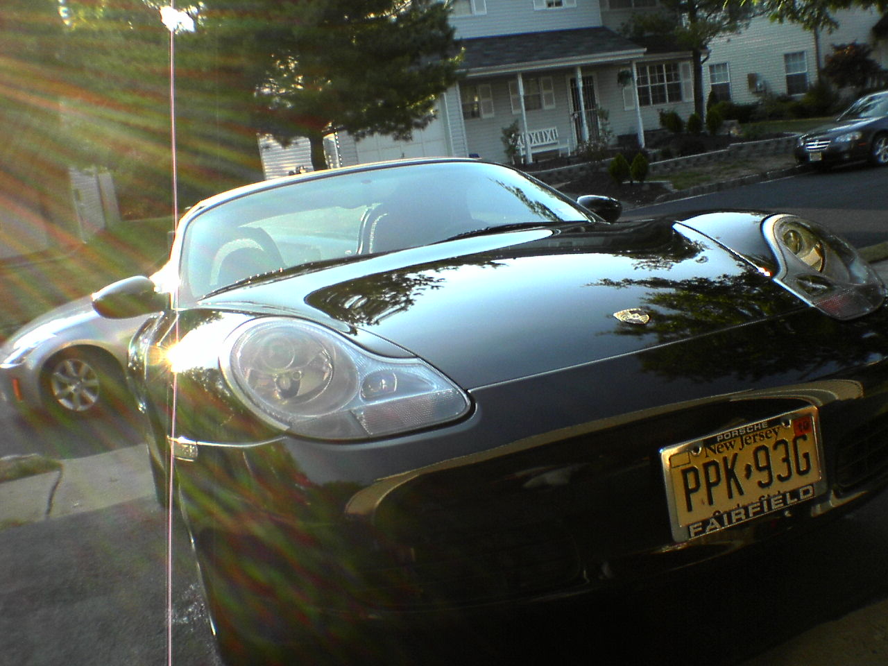

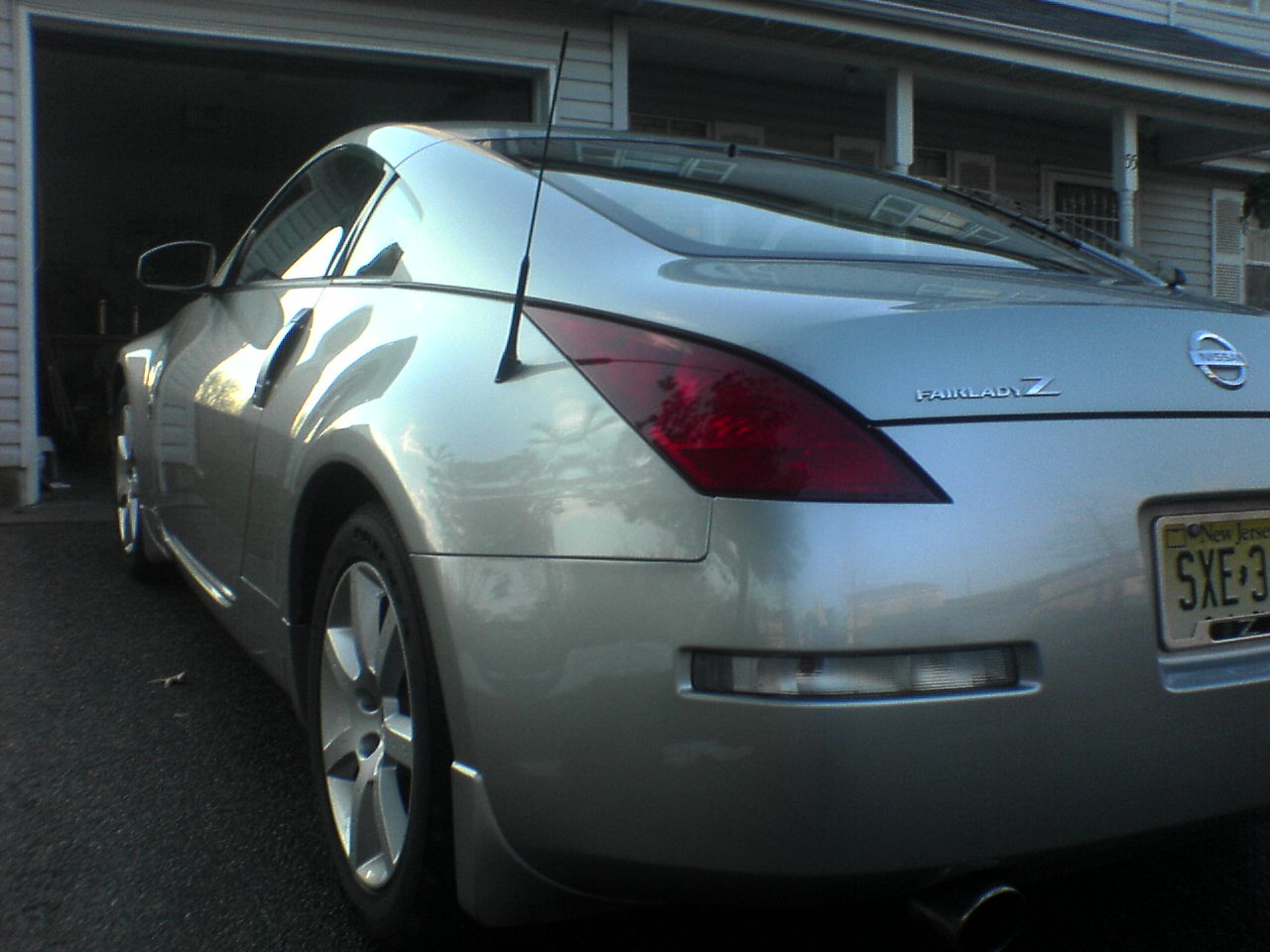

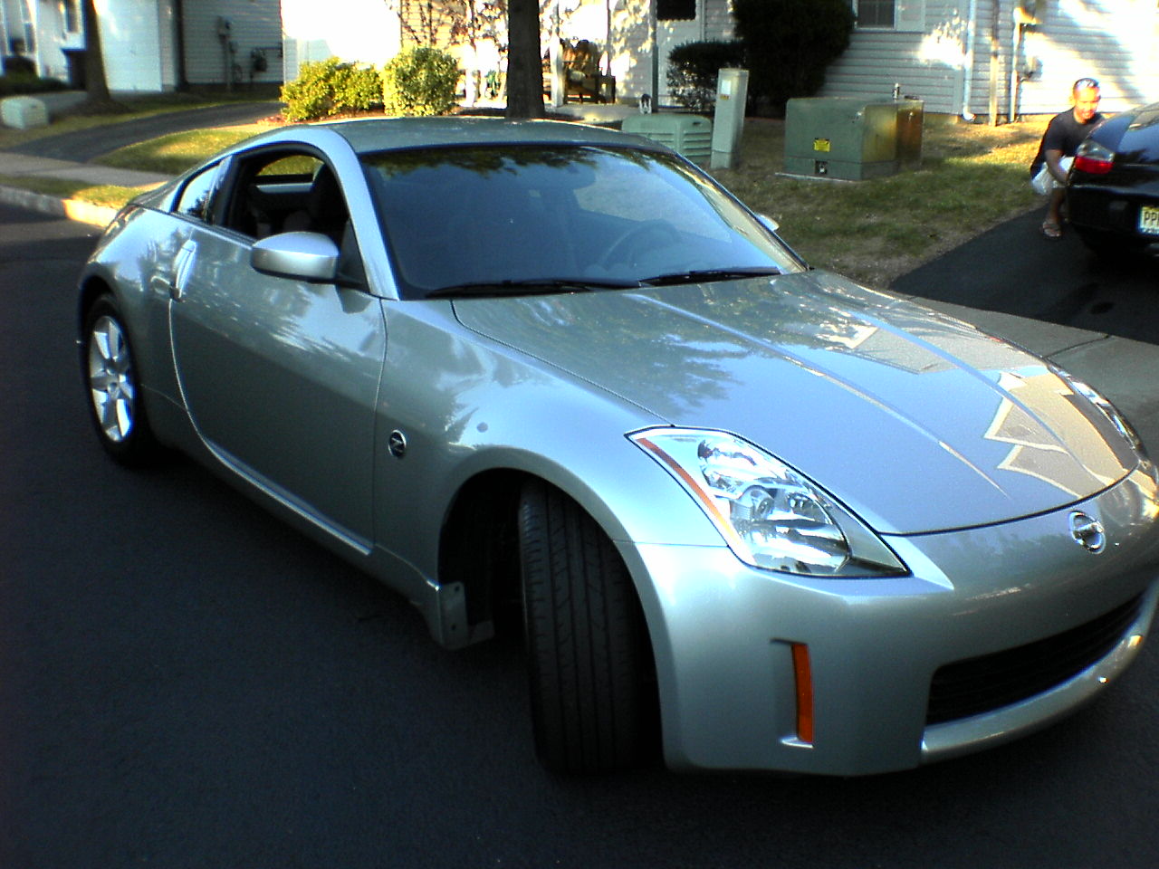

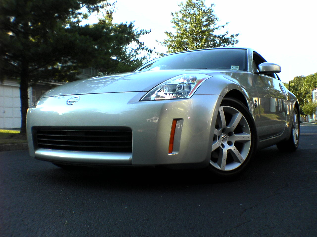

These are some pics of my car w/ Zaino spray, Zaino polish, Meguires 3 step..works nicely on silver, and the black porsche

:-D Thank you thank you. I did the shien on the boxter for my neighbor as a nice deed. Its claybar, meguires polish, Z5, Z6, Zspray. Took 2 hrs per car. Most of the time was waiting
