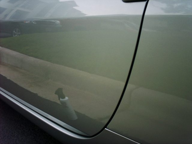

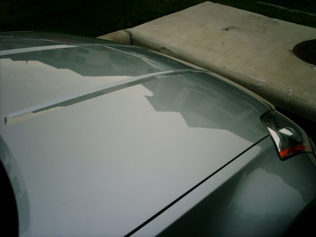

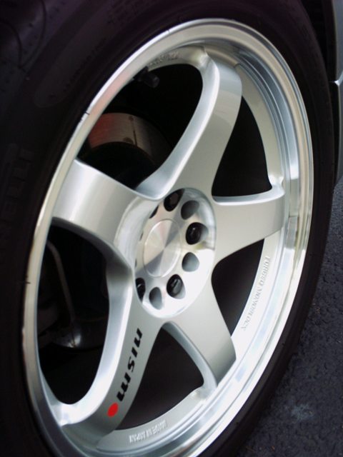

Well I finally made the switch to Zaino. Here's what I did this past weekend:
1. wash with liquid dawn
2. clay bar entire car
3. 1st coat of ZFX enabled Z2
4. clean with Z6
5. 2nd coat of ZFE enabled Z2
6. clean with Z6
7. 3rd coat of ZFX enabled Z2
8. clean with Z6
9. look at my car and smile
overall I am impressed with Zaino, the real question now is how long does this stuff last. My car is literally like a mirror now. I will say this, the shine is not like wax which makes the paint sort of "glow." The paint is now very, very reflective. The process was about 5-6 hours but not difficult, I only plan to do this twice a year.
enjoy the pics.

Nice pix! That second picture has a very nice reflection in it.
