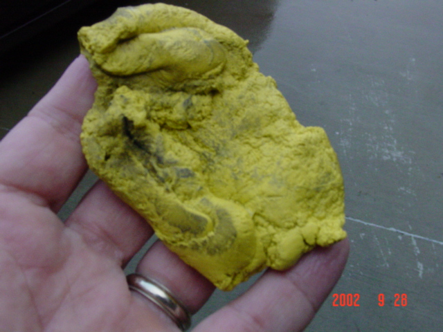

Look at this pic and you'll see why you still need to clay even a brand new car. There is obviously a lot of dust/dirt in the bottom of the Nissan ship and the back of a car carrier. Remember, it's a LONG way from Opama!
My Claybar after use on NEW 350Z
