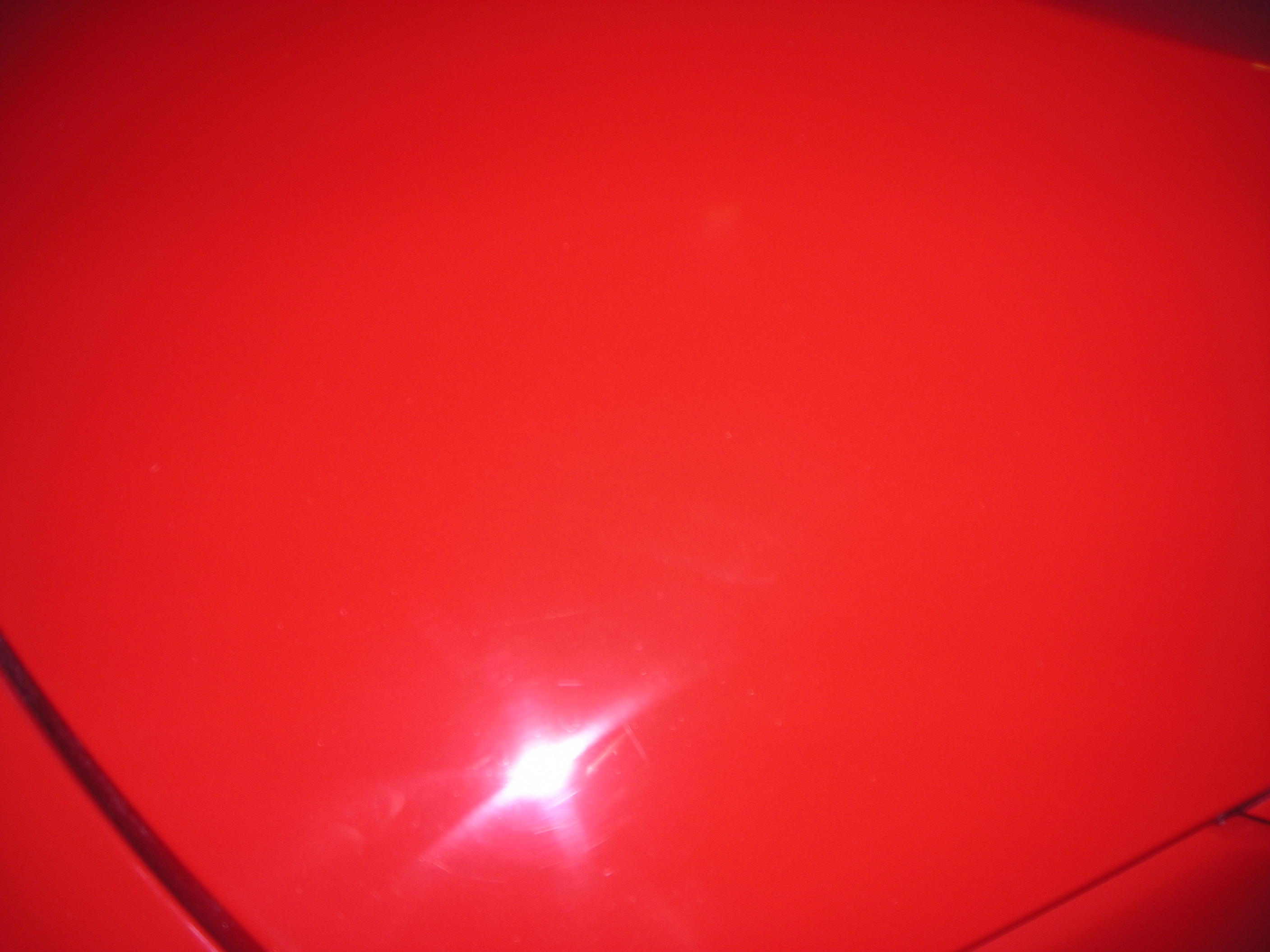

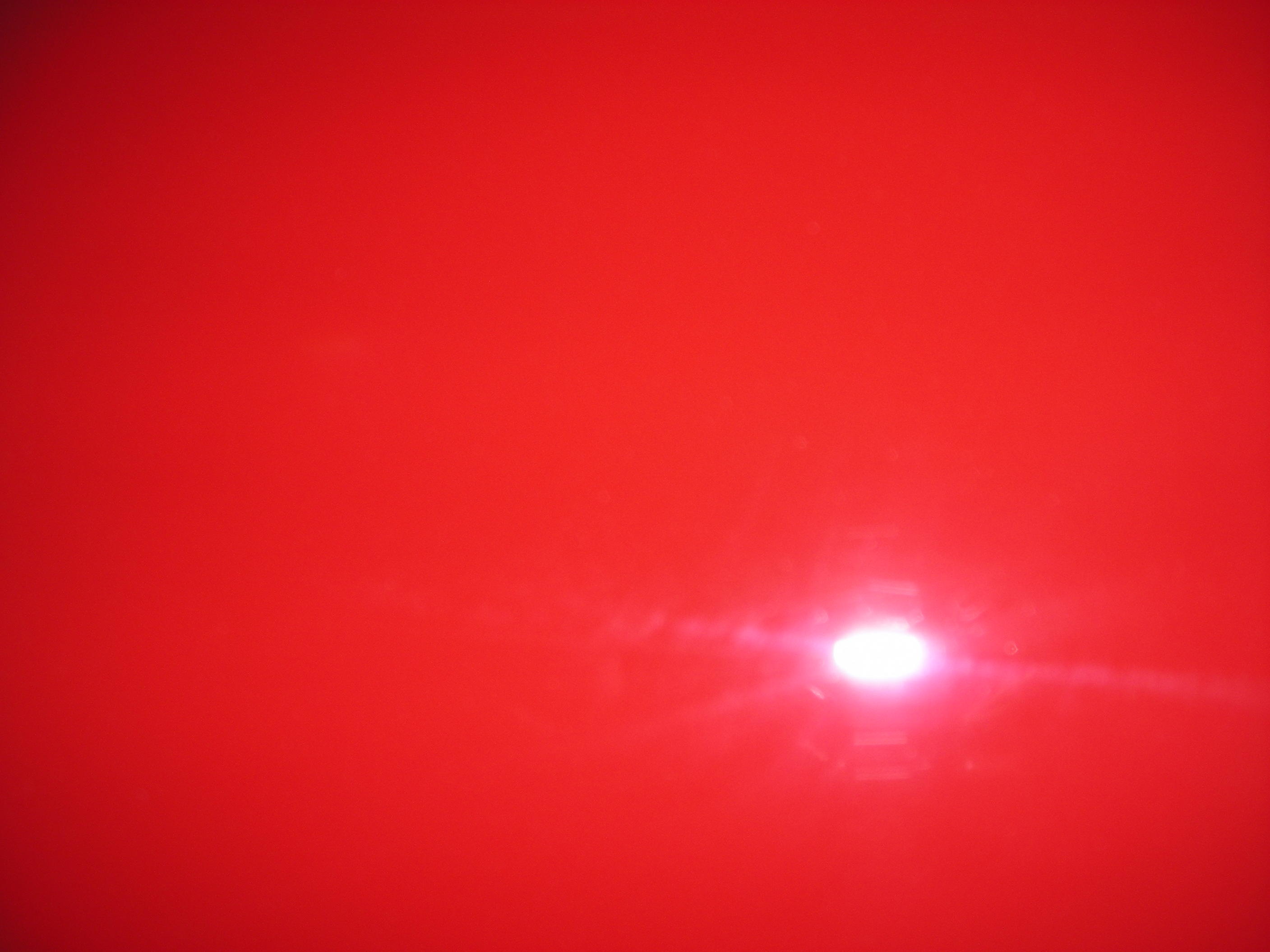

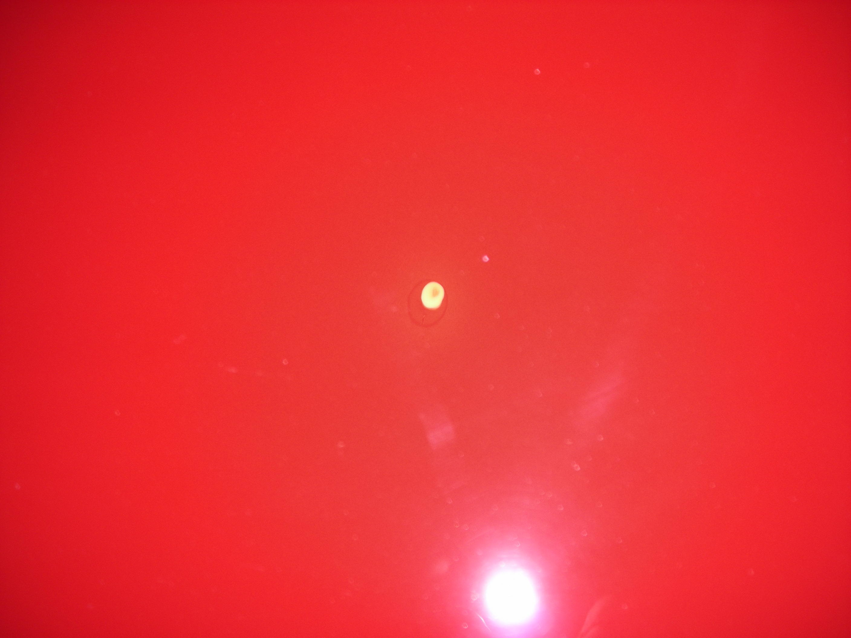

Default Detailing photos bad job
Here is the bad detailing job

The paint just looks hazy. I was expecting much worse. Hazing is cause by not following up a heavy cutting polish/compound with a finishing polish. It's an easy fix.
