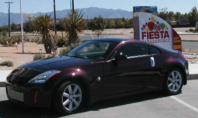

"Ditto" remarks of Conceyted! Your last coat should always be Z2, followed by Z6. Don't know if you have "swirls", but Z5 fills the "swirls". If you do, you might want to consider a 2nd or even a 3rd application of Z5 before moving on to Z2. I throw in an application of Z5 with every 3-4 of Z2. Also, while 100% cotton towels by Cannon or Fieldcrest are Ok, towels by dftowel.com are awesome!
