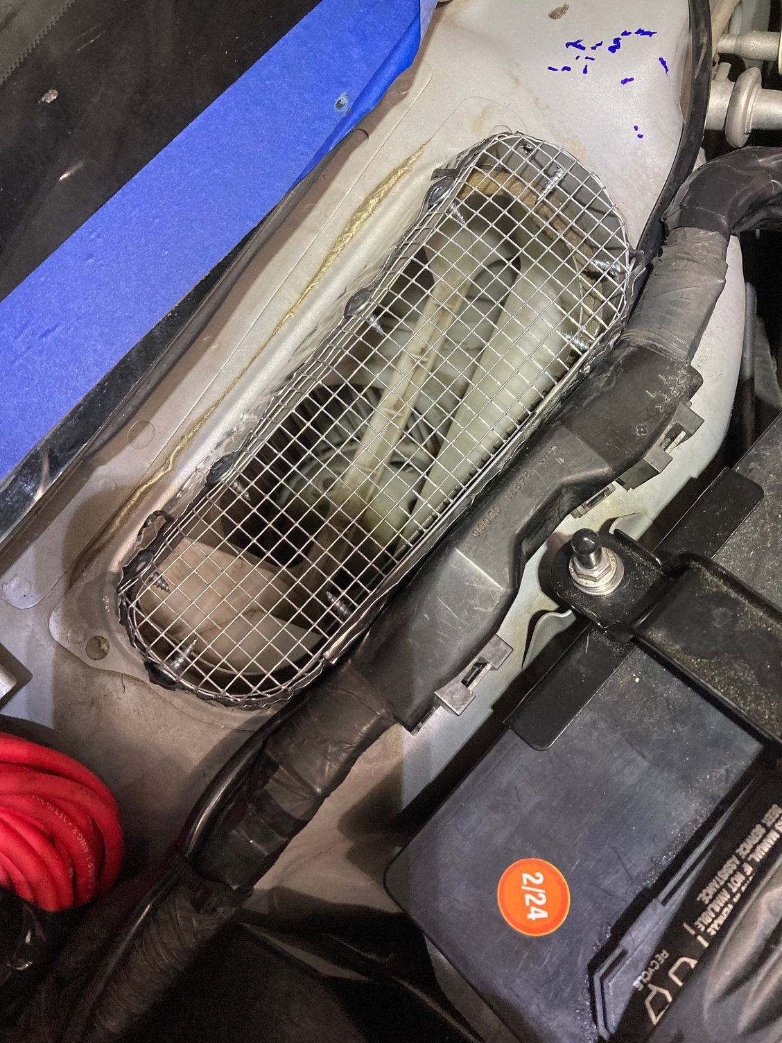

The little #!@&!'s won't be getting in through this spot anymore. My screws were a bit long. I know I had 3/8ths in my hand when I bought them, but they somehow grew to 9/16ths on the way home.

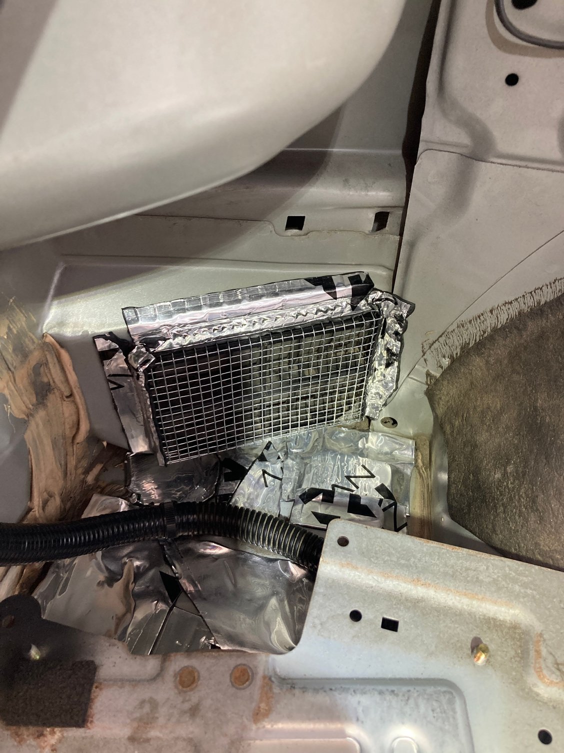

Looking at this photo of the inside of the rear hatch that black thing in the back corner is one of the vents you referred to. The other side has one, too. Both are closed but the rubber flaps are super thin and no doubt one of the little buggers if determined could get in even when these are "closed" Those will be getting screened off tomorrow. You were correct again. And I won't have to take off the rear bumper. Thanks, yet again.
Old Jun 8, 2025 | 10:48 AM
JSMCO's Avatar
JSMCO
Joined: Apr 2024
Posts: 87
From: CO

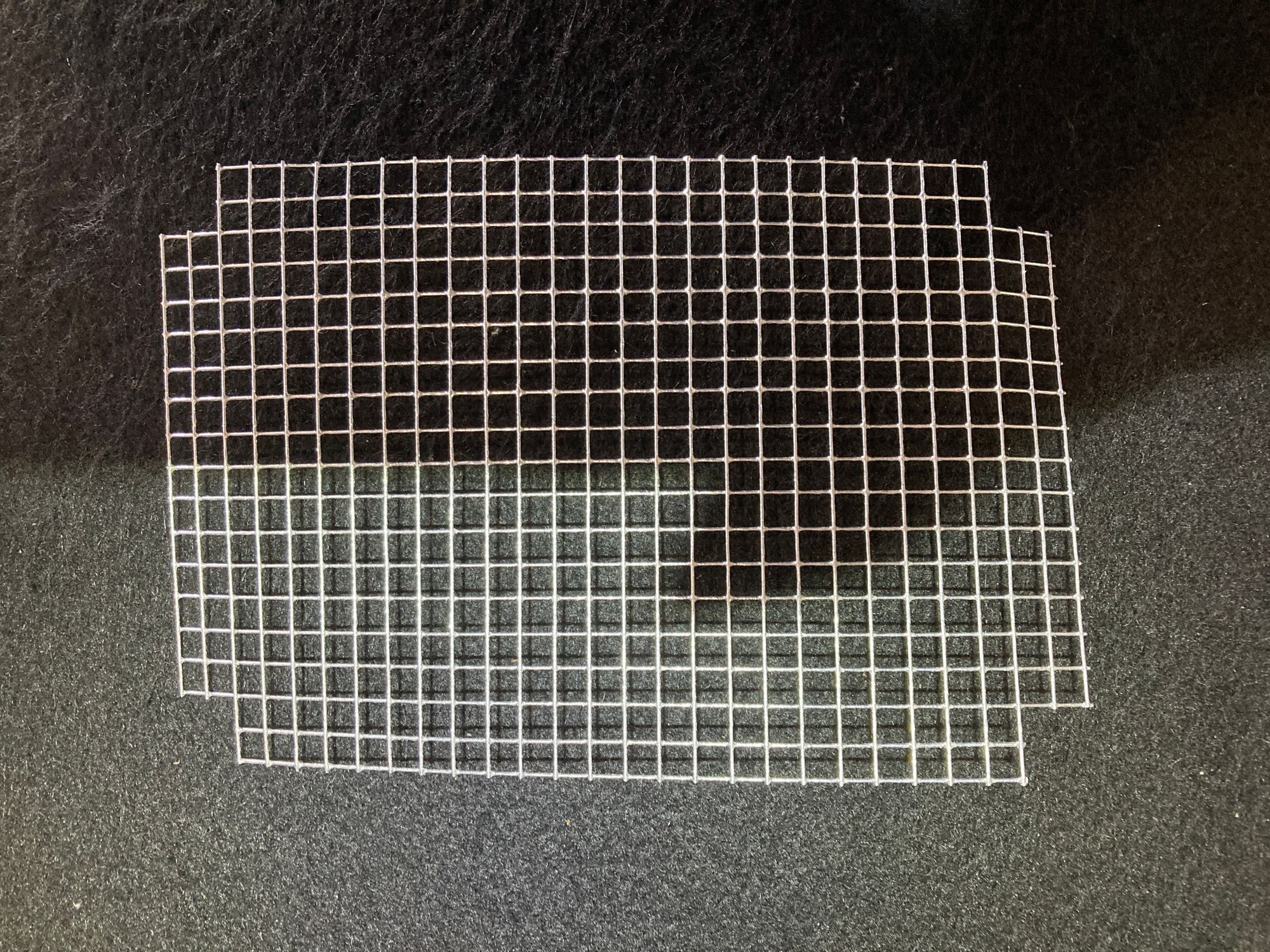

Guys, I though a couple tips might be helpful to anyone who has their hatch ripped apart and wants to screen off their rear vents in the future. The most tedious part I found was getting the screen to the right size & shape so hopefully this will help. I used 1/4" "Hardwire Wire" which was bought at Lowes in a roll in the garden center. I considered using an 8" x 8" wall patch that did have thin aluminum in it, but the holes were very small and I was concerned it may cause whistling, so I now have many feet of extra hardware wire.
You want to use tin snips to cut a piece of the screen that is 6 3/4" x 4 3/4". Then snip off two squares at each corner so you can fold it into a box like shape. Before folding it should look like this:
I snipped off the little nubs as close as possible using a pair off Knipex Super Snips. Excellent little tool for this and also snipping off the ends of zip ties flat so there's no sharp tail left.
Knipex's Knipex's
Then, just use a straight edge of a board or table to fold the flaps down to form a box cage. I didn't picture this. To finish off the 90 degree bend, I also used regular pliers and grabbed a little at a time until the box was just right.

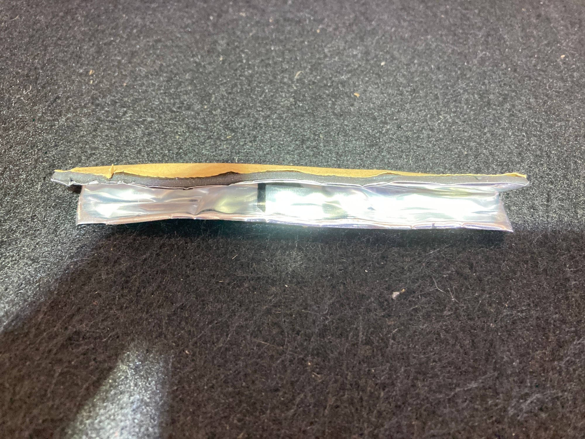

I opted to use some small strips of Dynamat to secure the cages. Cut the length of the strips a little shorter than the edge you're applying to, as it's a pain to try and fold extra over the corners.
Fold the strips into a tight U-shape like this before applying:
Then, place your perfect sized cage over the vent and stick the Dynamat strips first to the vent & cage. Hard to get a roller in there, I used the flat edge of a screwdriver and blunt end of a dowel to flatten and adhere it. Then unfold the strip, laying it against the metal from the cage outward, again pressing and adhering it with the flat edge of the screwdriver. Do one strip at a time and use your roller when done where you can fit it. I did 3 sides, the bottoms seemed like too much effort and not needed, unless you're unlucky enough that Mighty Mouse tries to enter your car. If you can crawl in your hatch and lay down, the bottoms could be done, but that was not something I wanted to undertake. I won't win any awards for Dynamat application perfection, but the screens are secure and will serve the purpose.
Here is the finished product:

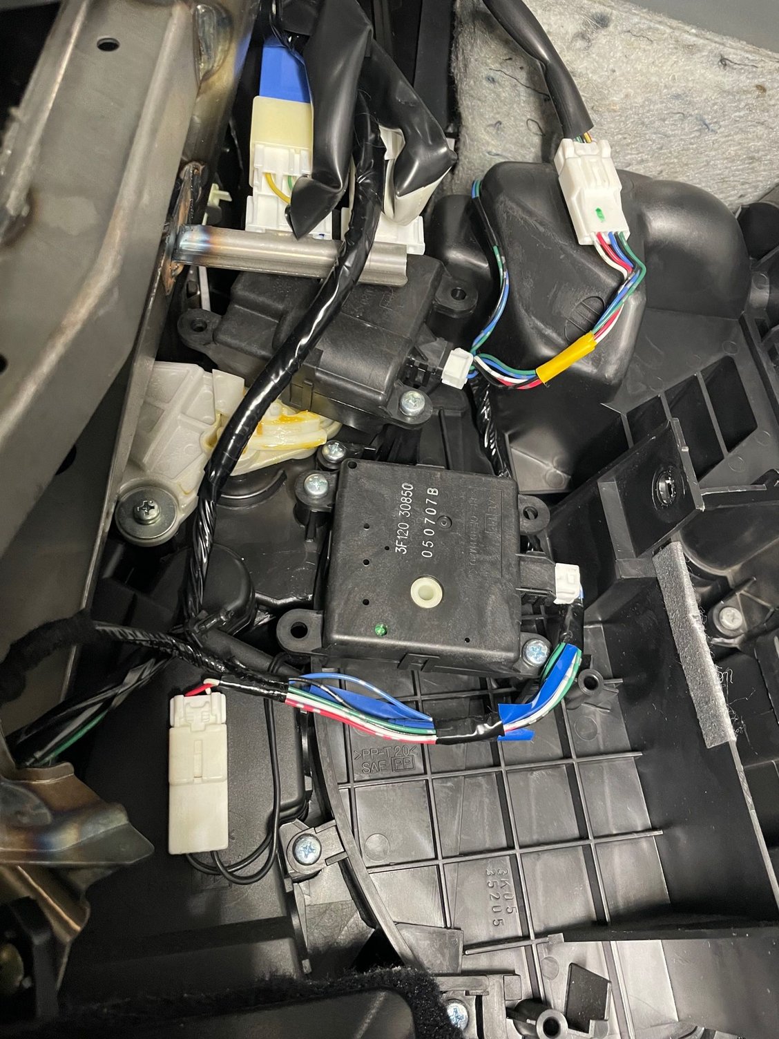

Thanks again for the suggestion. Are there more blend doors in the box other than the two that can be seen from the under-cowl intake under the hood? Because I can see those pretty clearly, and the weather stripping on those looks intact. The only materials I found in my cleaning endeavors were insulation and some little pieces of styrofoam, which he chewed from the L-shaped block under the passenger carpet. And as far as I can tell, only one wire in the dash was slightly damaged. The yellow & red one that goes into a connector all by itself, as shown here:
No idea what that wire is for, or why there's a big connector with just one wire going into it, but I wrapped it up well with correct color yellow and red tape (thinking about the next guy) and maybe I'll peruse the wiring diagrams again if curiosity gets the best of me.
4 total receptacles.  One only has one red & yellow wire, which needs some TLC from a non-friendly mouse.  I don't think that one or the smaller one on the top right were connected to anything.  The big one in the middle the head unit switched power, battery constant, and the front speaker wires go into.  The one on the bottom right is again where the rear speaker wires and the blue/white remote wire go into.  I don't know if any of these connectors lead to the Bose amp in the rear.

There are more blend doors, but they are located inside the Heater Core/Evap. Core box. You would need to take out the entire dash to get to those, not worth the effort unless they confirmed broken or not functioning properly.
Just a hunch, but I think that single wire (yellow/red) going to the white connector in the photo is for steering wheel audio controls. I could be wrong of course, but I know the steering wheel control setup for Bose equipped Zs is different. On non-Bose Zs, it's a 3-wire brown connector. Some aftermarket adapters use a single wire input.
Did you ever figure out what the crimped bellcap was for on the BCM harness? Looked like the previous guy spliced two wires together, which might not be a good thing, could be a cause of some of your other electrical problems.
