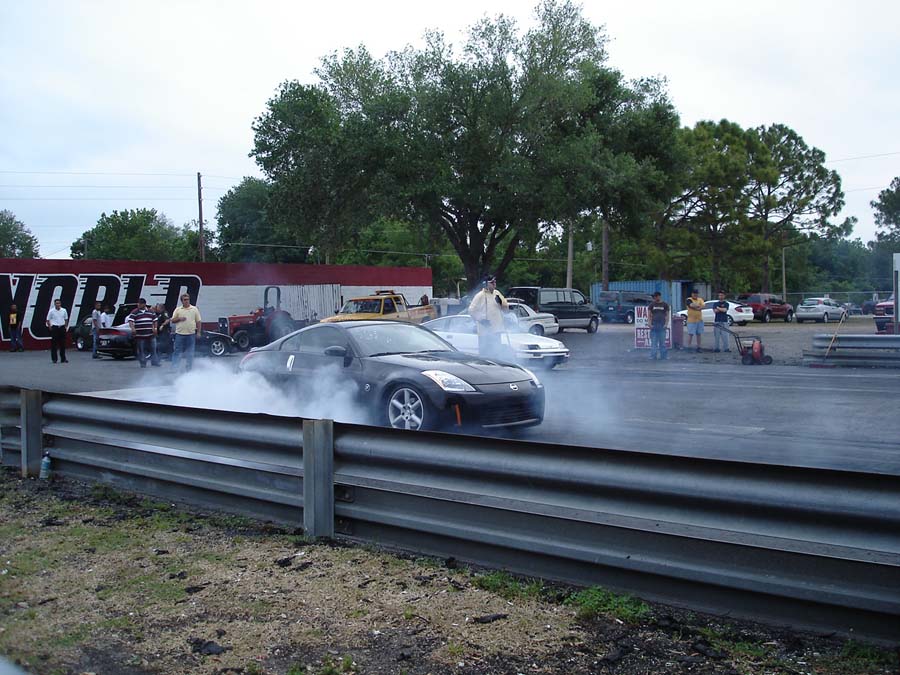

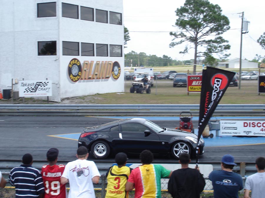

i will tell you right now, unless it was 90 degrees outside when you ran your nitrous pressure was sooooo low that it probably didnt do anything
nitrous is all about bottle pressure, if i hit it at 850 psi, which is about 75 outside, it will barely pull, if i hit it at 950-1000 it will brake loose my tires going 100 mph down the street. all about pressure, the next thing you need to buy is a bottle heater.
when you put that brake fuse on a switch, sit there and floor your car and barely press down the brake, sit there for about 8 seconds till the tires really start smoking. with your stall convertor you should be pulling nice 60 foot times. i had an automatic G35 on 100 shot pulling low 1.8s with no stall and no brake fuse switch.
if you know anything about tuning then the utec will be easy for you to do. there is no software needed. it comes with all of it. make SURE you order the TUNER WIDEBAND with it, it will datalog the AF ratio along with all the rpms so you will know exactly where you are at
the fuel jets with your nitrous system should be 58 and 30 with the stock PSI. if you are running higher fuel psi then the jet should be smaller. i would try to keep your overall air fuel ratio in the mid 10s (still really safe without overdoing it)
good luck and any other questions, post them and we will try to help as much as we can!!!!
dont forget that bottle heater and make sure you run 950-1075 pressure on a quarter mile run. i ran 11.94 @115.5 with JUST those jets 57/30 in my Z....
