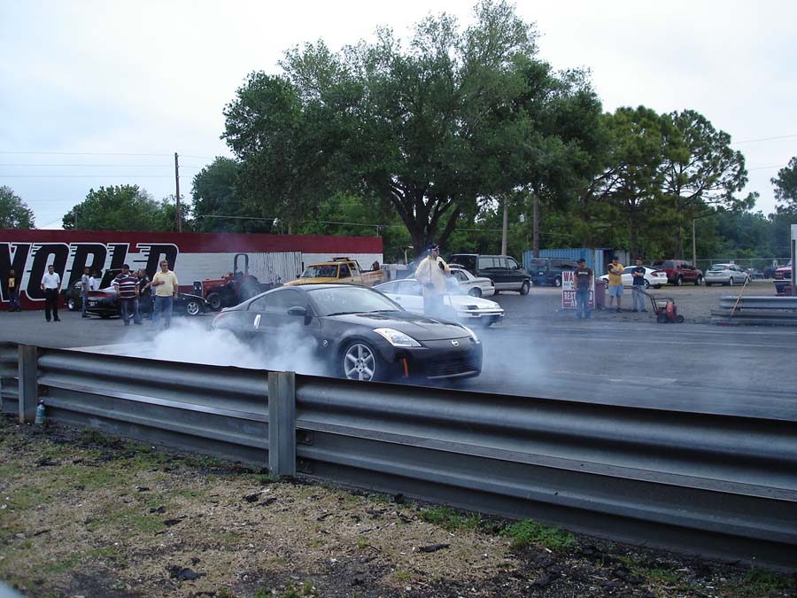

i think if you are going with "slicks" i wouldnt go with wider that 8.5, its just over kill. if you are going MT ET streets then maybe a bit wider like alberto said.
i am launching at 6000 with a stock clutch and slicks 26X8.5 with no slip or spin pulling 1.63s. i dont think you have to worry about breaking stuff yet. you are more likely to break something with drag radials because of the wheel hop. slicks actually absorb all of that cause of the soft tire and sidewall.
i drive my cars like i am trying to break them at the track. if i havent broken anything the way i am launching, i wouldnt worry much...
with the burnout.... pull out the brake fuse. pull in the water in first gear. spin them for about a second. try to spin the tire at least three or four times around. pull up a bit after that. PUT THE CAR IN 2ND GEAR. drop the clutch and lightly lightly press the brake, if you hit the brake too hard it will bog the car down. barely pressing it will make the whole car sit still.
i do a burnout for about 8 seconds. nice and hot!!!
good luck and let us know how you do...
