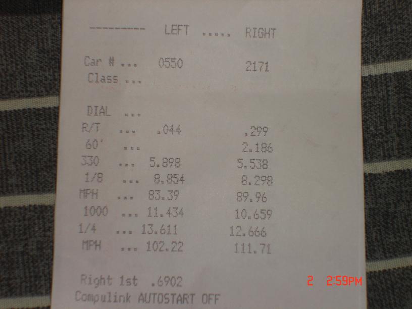

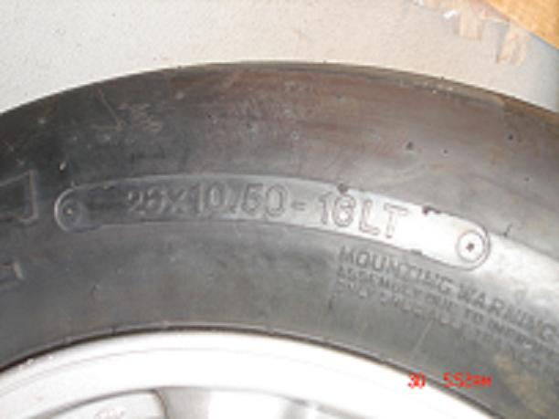

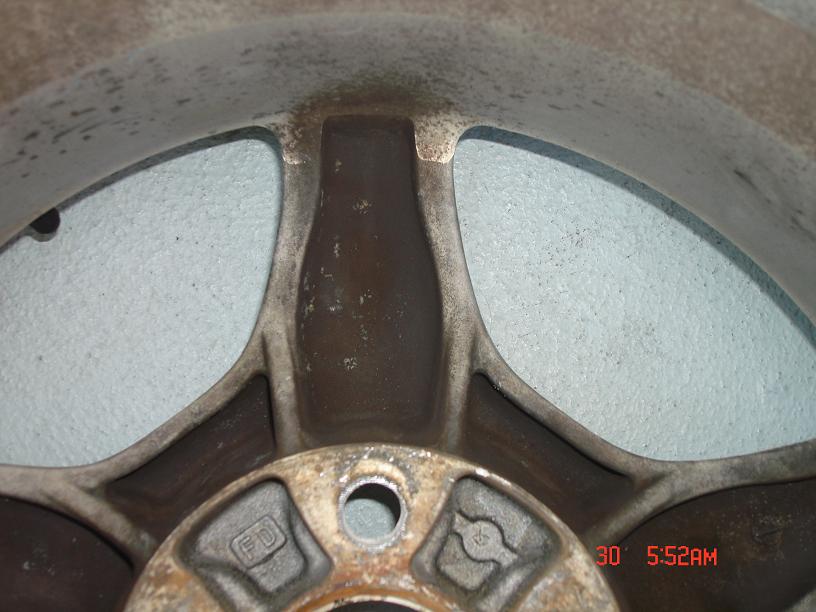

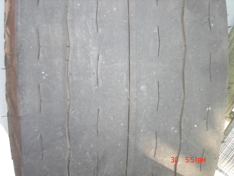

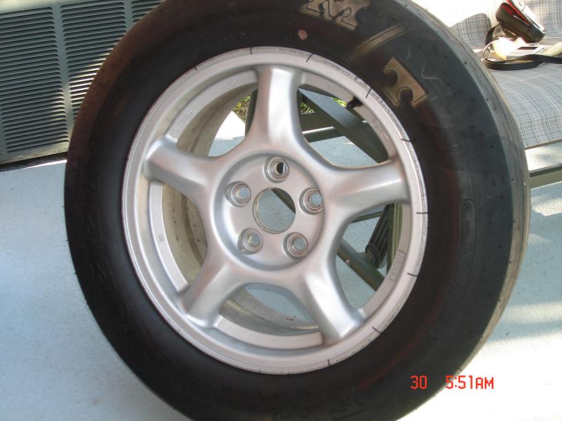

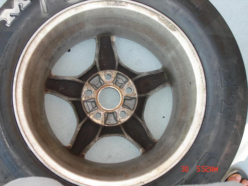

Well as some of you may know i bought some RX-7 3rd gen wheels the unreinforced versions with some MT' et streets. I went to moroso in the quest to break the 11's. Before i had done 12.3 at 113 in my 19 iforged wheels with toyo t1-s. Well i figuered with the FD wheels and MT et streed i would have a chance at breaking the 11's. BTW i think my 19's weight easily 25 pounds over the FD wheels. Well i was really wrong.
I got to the track jacked the car and swap to the FD wheels. I go inspect my car. Then I and get in line and wait to run the car. Well i have to say it was consistent i range in speed only twice 109 to 111 all the time and ET was 12.7 to 12.5. I really dont know what it was but i just couldnt get my speed going my best 0 to 60 was a 1.999 which i have gotten better then that. I dont know what went wrong here but im really dissapointed and confused.
Can anyone explain to me what is going on or tell me something that i dont know.
Ill post VID's and pics later
Attached Thumbnails Results of moroso "VERY DISSAPOINTED"-350z-018.jpg   Results of moroso "VERY DISSAPOINTED"-350z-019.jpg   Results of moroso "VERY DISSAPOINTED"-350z-020.jpg   Results of moroso "VERY DISSAPOINTED"-350z-021.jpg   Results of moroso "VERY DISSAPOINTED"-350z-022.jpg

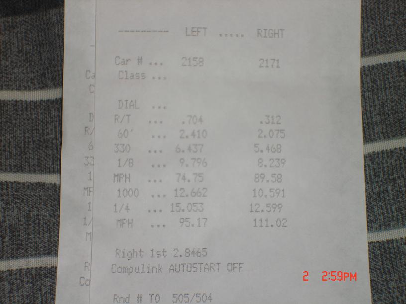

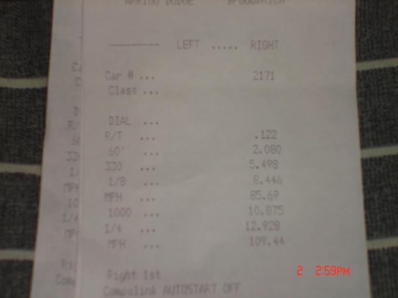

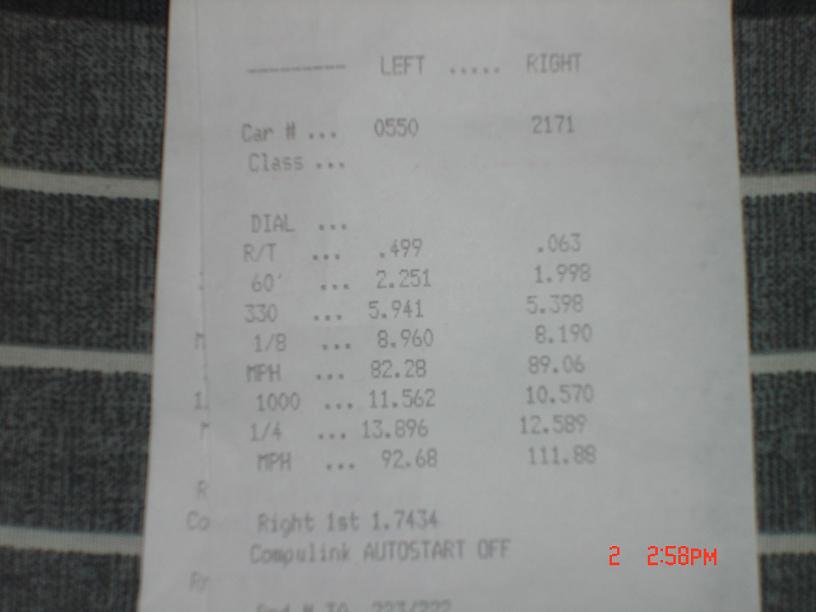

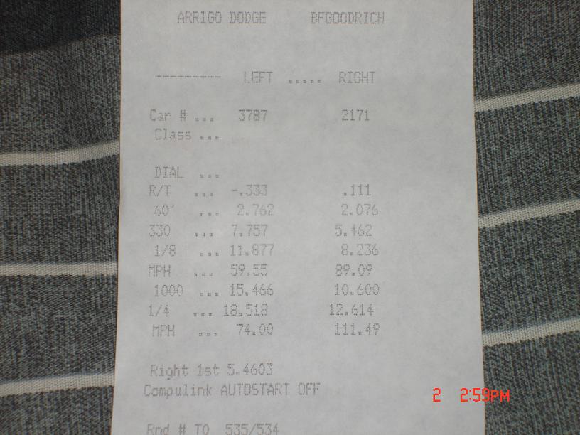

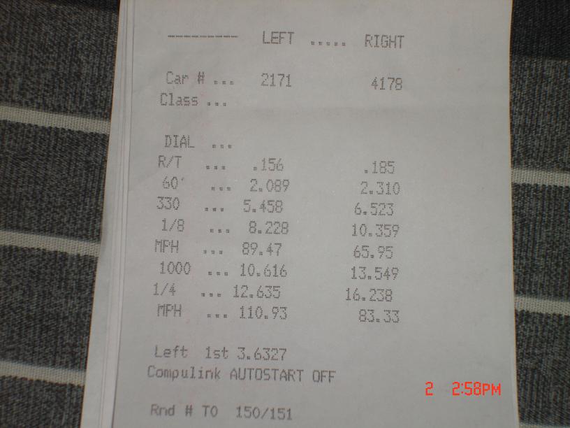

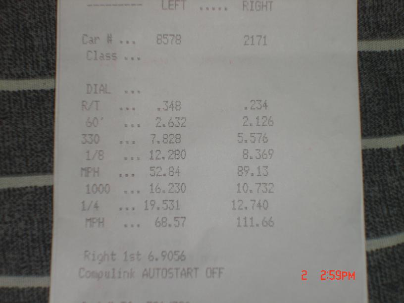

Time slip
Attached Thumbnails Results of moroso "VERY DISSAPOINTED"-350z-045.jpg   Results of moroso "VERY DISSAPOINTED"-350z-046.jpg   Results of moroso "VERY DISSAPOINTED"-350z-047.jpg   Results of moroso "VERY DISSAPOINTED"-350z-048.jpg   Results of moroso "VERY DISSAPOINTED"-350z-049.jpg

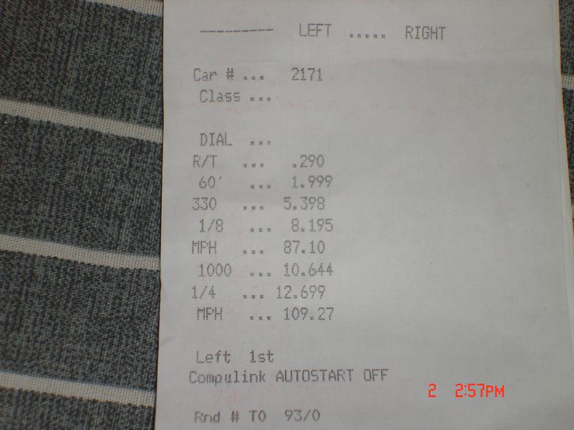

This are the last 3 with my 19's

It would be helpful if you posted some time slips.
Temperature?
Humidity?
Barometric pressure?
Old Jun 2, 2006 | 11:27 PM
Fairlady_z33's Avatar
Fairlady_z33
iTrader: (56)
Posts: 1,894
From: Miami
I dont know humidity or baromatric pressure i know the temperature was around 83 to 85 and if im not wrong it was kinda humid but dont really know.
Old Jun 2, 2006 | 11:44 PM
davidv's Avatar
davidv
Posts: 42,753
From: Tucson, AZ
Thanks. 2.0 - 2.1 second 60-foot time looks like my street tires. 2.0 - 2.1 seconds is consistent so you know that your technique is good.
1/8 mile mph: 89
1/4 mile mph: 111
In the second 660 feet you are picking up only 22mph. This is reasonable for a naturally aspirated 350Z with simple bolt-ons.
My unprofessional conclusion: Heat and humidity are killing your ET. Don't be discouraged. My best ET is 13.40 seconds. Last weekend I was running 14.0 seconds. Same track.

you have way too much pressure in those tires, dangerously so. You are not to put more than 30 psi into these tires and if you start out with 30 and then do a burnout you're at probaly 32 ro so....be careful
try out between 15.5 and 18. I actually had the best results at 13 with a 1.66 60'
here's a link to the MT recomended site:
http://www.mickeythompsontires.com/tech_pressure.html
