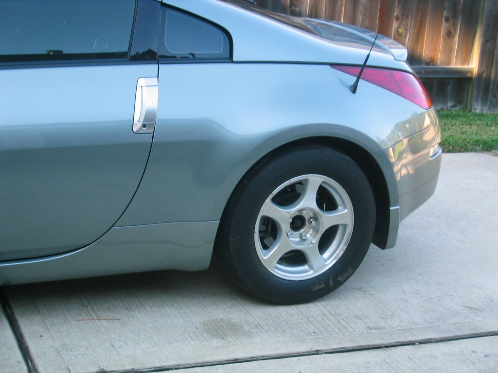

I am wondering if they will fit the lug pattern and clear my brembos..
I will be using them for drag racing..

I pretty sure they will fit on a Z (or G) but Im not sure about clearing brembos.

+1 on most likley not clearing brembos...some 17"'s don't clear brembos. what offset are they? I assume they're a 5X114.3 lug pattern?

since oem wheels dont have agresive offsets and these are 16 inch wheels youll most likely need spacers before you can even start to think theyll clear.
why not just use the rears?

Exactly what I am going to do but I have Brembos on the rears too..

btw those mustang wheels are 7 or 7.5 wide IIRC

I am hoping a certain person has some Cobra-R wheels still up for sale.. I have the Brembos and the Cobras have a +24 offset and so do my rear Volks.. Soooo, I am thinking that they will work.. If they are for sale, they wil be sold.. Tomorrow!

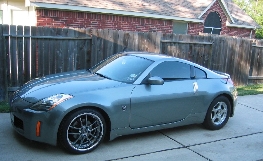

The bolt pattern will fit, I've got some v6 mustang wheels myself... no brembos.

JG, what size tires are those on the mustang rims? Probably gonna go with a pair of 300zx wheels myself.

26x10.5

I am going to get some Cobra-R wheels.. The Mustang Cobra-R SVT rims have 5.98" of backspacing (+24mm offset).
My Volks have a +24 offset on the rears.. I will have pics later tonight to show.. They should fit......
