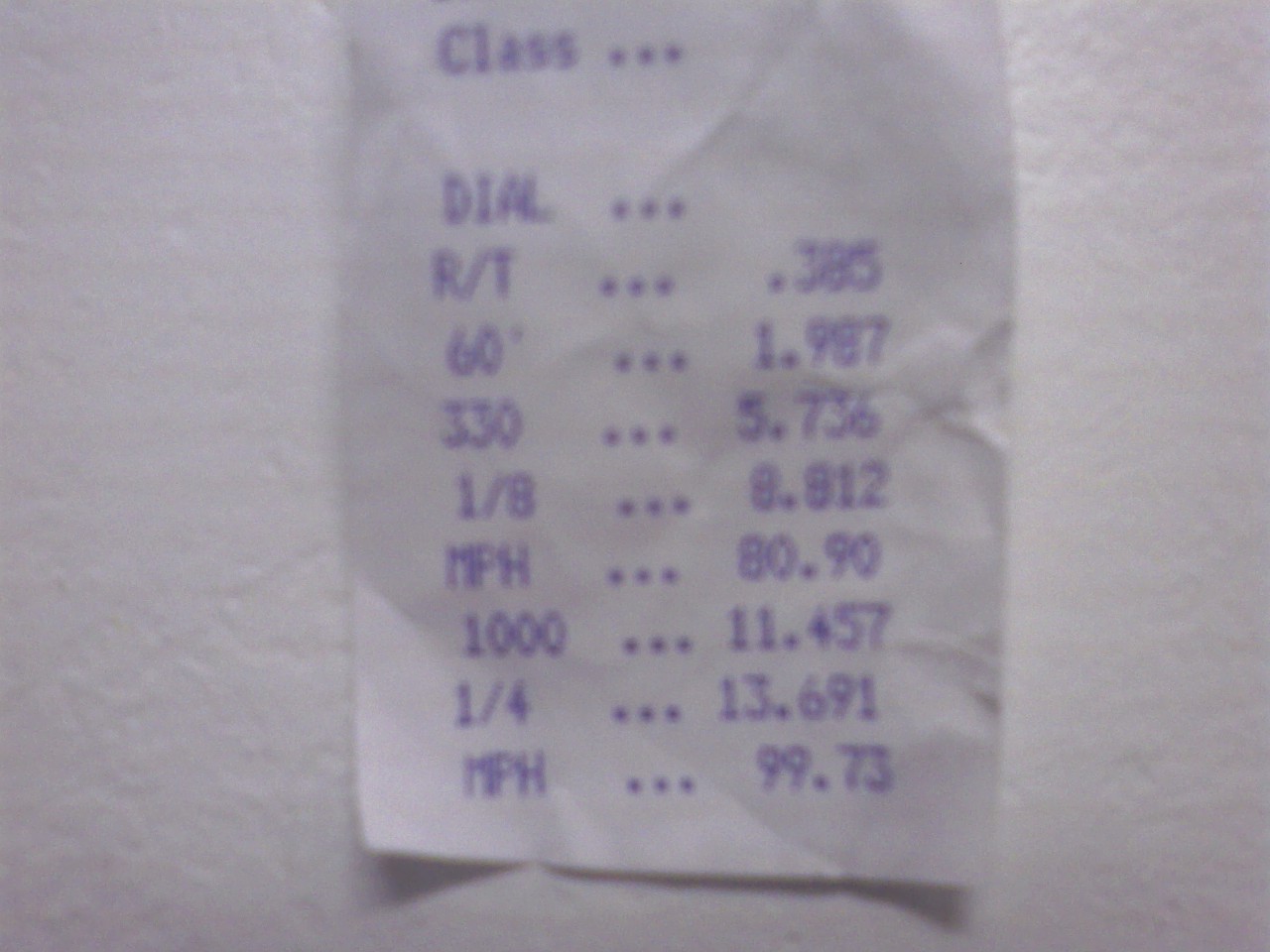

here is my slip

Old Mar 1, 2007 | 04:20 PM

What track was this on?
From the looks of your time slip, it looks like you're losing steam in the last 1/8 mile. Your launch is good and so is most of the first 1/8, then your acceleration seems to suffer toward the 1/8th mile mark. It stays that way until the end of the 1/4 mile.
Or maybe, the track's last 1/8 mile is just short, thus giving you a great time but smaller trap speed.
I know that the tracks down in Houston gives better times than the one by Dallas. Not exactly sure why.

Originally Posted by keznevin
here is my slip
Excellent 60-foot time and ET. Are you certain that you are not letting your foot off the gas before the finish line. Besides that I don't have a clue.
Here are two 100mph plus runs. Your ET is better.

it is at houston raceway park
Actually, that explains why you got such a great ET, but not so great trap speed.
I know another member who's gotten a 13.8@100 with little to no mods at Houston Raceway Park, but can't even break into 13s at the track (TX Motorplex) where I race. And that's with most of the bolt ons available for NA. Also, that track is easier to pull 2.0's than the one near TX Motorplex, comparing his times there and here.

I don't know man. 80.9mph in the 1/8th is pretty strong, but picking up less than 19mph in the last half decidedly is not. And there's only one more shift after the 1/8, so it's not shifting speed.
When are you making your 3>4 shift? What rpm? And what size tires are you running in the rear?

19 in the last half is weak, make sure that you floor your car ALL the way through the traps, maybe you dont know where the end of the track is.

I dont know other than maybe you're letting off early. The 1/8 is good.
Again, this track, compared to others, spits out better ET with slower trap. Otherwise, there's no way that other member can only do 14.0 at best at the track I go to with lots of mods, but can do 13.8 at the houston track with couple of mods.
OP, try a different track and see if you get the same results. I still believe it's the track and not you/your car.
