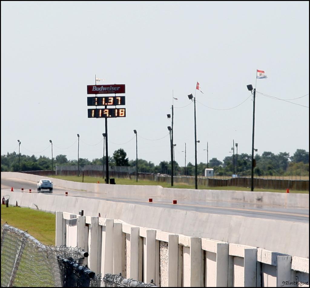

Default 11.2 Stock Block ***VIDEO***
60' 1.598
330 4.640
1/8 7.181
MPH 96.14
1000 9.371
1/4 11.238 <----- Backed this up with an 11.3 @ 119
MPH 120.06
Video!http://www.youtube.com/watch?v=HEZrd_CbomU
http://www.youtube.com/watch?v=tHezMszyADc
03 Base full interior w/ leather seats minus spare
Engine/Drive-train: Stock block w/ 6MT rocking the factory clutch and VLSD
Turbo Kit: Out-the-box Turbonetics Tuner Kit(jetpilots old kit), 650 injectors and UTEC w/ 50 shot of nitrous.
Tires/Suspension: 18" 245's up front on racingharts w/ 275/60/15 ET Street Radials on 15X8 Weld Prostars. Intrax springs, stock shocks and factory spec rear camber.
Tuner: Jeremy @ Performance Factory
Mechanic: Me
Power Level: Dyno'd 40Xhp w/ NO2! Sounds low but I'm running factory B-pipe for exhaust and I think the nitrous shot is rated higher than it actually is.
Discuss!

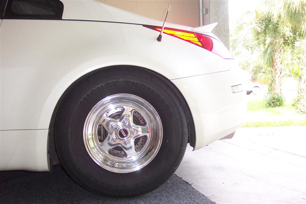

Thanks, I'm floored me to be honest! I ran an 11.8 with the 150 shot w/ these DR's and that dyno'd at 356/417. So when we dyno'd with the turbo kit and saw low #'s I was thinking 11.8's again.
Thing is with nitrous your peak power is at the lower rpm's and falls off as rpm's rise. When i dyno'd the nitrous the 356hp was at 4500 and fell to about 340 which isn't bad but the trq went from 417 to almost 300 at redline. The instant trq will get you a great 1/8 but traps suck!
This just shows how important the power curve is!
With my short shifter and quick feet, I was keeping my rpm's above 5300 so I was always near my peak power.
Alberto, yank those brembos and get you some of these! No sway at all with 245's up front. Your experience lately got me worried but at those speeds it was solid! I cut 1.5's with 18psi in the tires

My Brembo's get ragged as bad as my tranny believe it or not. Paint chipping from the extreme heat after 1 weekend of spirited driving-I wouldnt have it any other way I am looking into the 16 X 27" (actual is 27.7") DR's though, I'll just pudge them on my 8" wide Welds. Powerband differences certainly come into play you can see it with the times.
