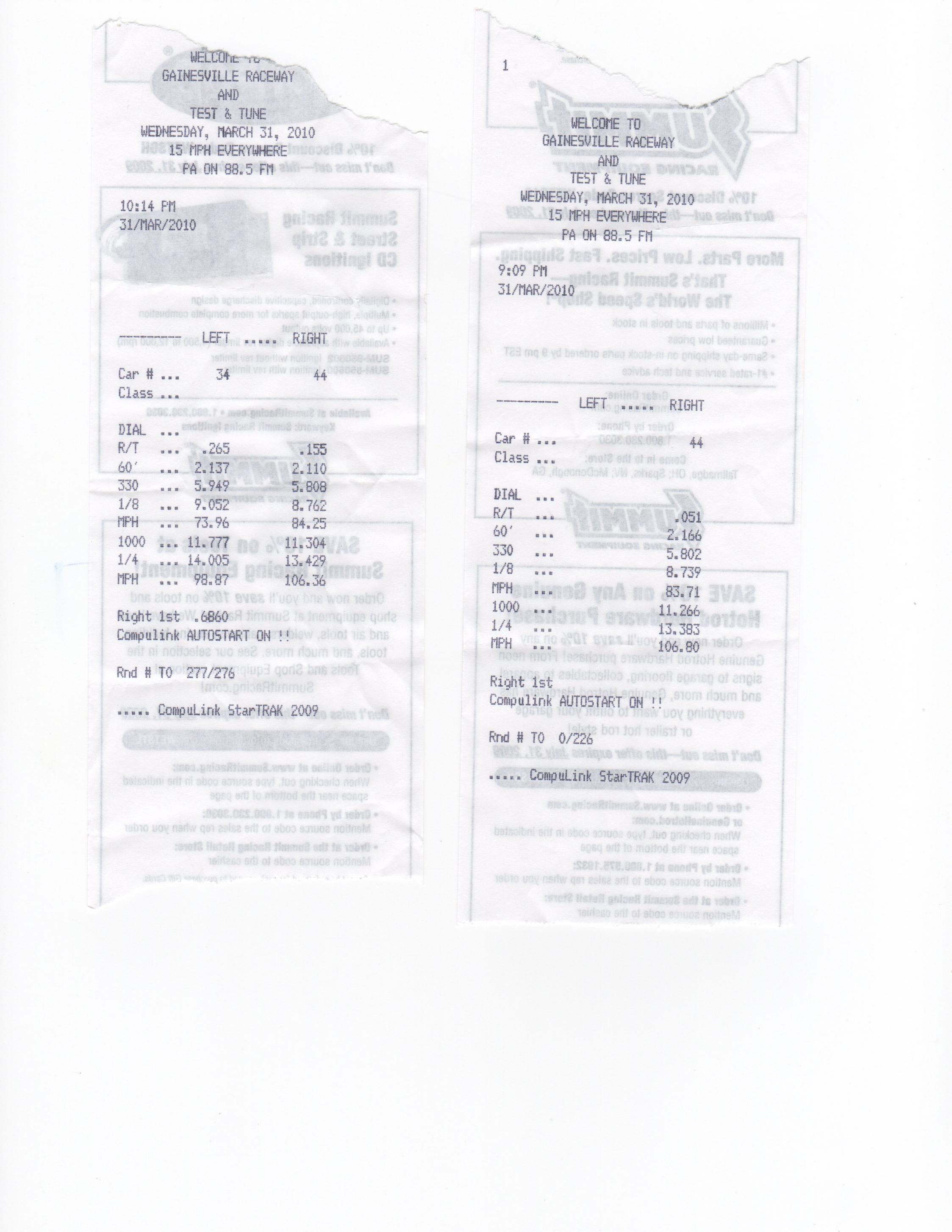

OP, post your slip. That is the easiest way for us to see where you are scrubbing off speed. 2.0 is solid on street tires......not great, but good.

Here's two of my passes. Most were within this range...pretty consistent.
I was right side both times.
I dont really preload becasue I have a 6MT. all I really know about preloading a manual is to ever-so-slightly ease up on the clutch when im staged, just to the point of when you move up a hair.
