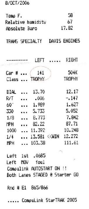

This was PB a few years ago....on the right hand side:

I assume mid 13 is 13.5X seconds? Yes I have one.
