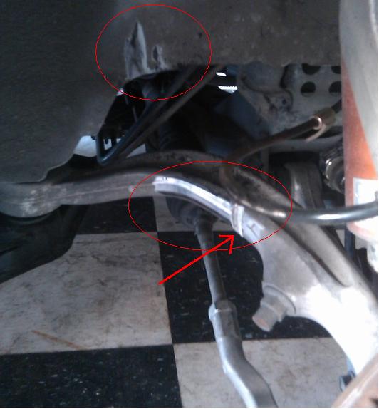

Originally Posted by daytona350z
this is my car with a 8.5in rim 245 tires, with a 33mm offset. i think i need to run spacers so i dont hit the lower control arm.
yes, spacers for sure....offset is crucial when increasing steering angle with wider wheels.....
-Also, look into getting SPL compression arm bushings as you will tear that oem bushing even FASTER with this kit...
-The rim of the wheel will eat into the compression arm...
-The tire will contact the inner fender wheel well and can burst....
-The brake line routing is crucial - i recommend SS lines for durability as well since a busted or belted tire can eat through a typical hose brake line.
I have gotten to about 1/3 through the compression arm before swapping it out...
PIC:
-J
