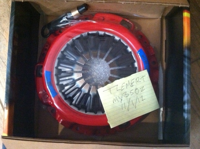

Bought this back at the beginning of October but never got the chance to install it before putting the Z up for sale. My loss is your gain!
$350 shipped in mainland U.S. Price is obo, but be reasonable please!
Shipping from Franklin, Ohio
Thanks for looking!

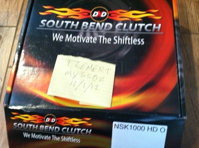

The # you have there on the box is NOT for an HR..The HR kits have a *B* inserted:
SBC Part # NSK1000B-HD-O
That is a kit for 2003-2006
SBC Part # NSK1000-HD-O
EDITED:
THIS DOES FIT BOTH THE HR AND THE DE
EXPLANATION GIVEN IN SUBSEQUENT POST

If you're gonna sell this..you need to straighten this out. How could they sell you the wrong one if you specified an HR? Thing is..you would never know and once installed, your CSC would eventually fail because the fingers on the Pressure Plates are different.
Old Nov 5, 2012 | 07:17 PM
ZSpeedPerformance's Avatar
ZSpeedPerformance
Vendor - Former Vendor
iTrader: (71)
Joined: Oct 2009
Posts: 2,001
Likes: 22
From: Vandalia, Ohio
You are WAY off.
It will not cause the CSC to fail, All South Bend kits have been updated over 2 years ago to work perfectly with the DE, HR or VHR cars. They all use the same kit.
The only thing that will cause the slave to fail is the stock slave, Its junk and should never be used with an aftermarket clutch. Has nothing to do with finger design but more to do with seal design and slave construction. Very early JWT kits were the only ones that had issues with the finger design, The hole was too big in the diaphragm spring and the slave bearing could possibly work its way through the fingers and over extend blowing out the slave. They fixed this issue way back. South Bend never had this issue as they used a different style pressure plate with longer fingers and bearing contact was not an issue.
A "B" in the clutch part number has absolutely nothing to do with what it fits. The "B" is actually which disk material the kit uses. "B" would mean it is a ceramic kit of some sort.
"O" Organic, "B" ceramic, "OFE" Organic/Feramic dual friction Ect.
The NSK-1000"B" on South Bends website simply means it doesnt come with a throw out bearing as the HR doesn't need it because it is part of the CSC assy.
We worked very closely with South Bend Clutch as we have for over 10 years designing the Z car kits, We know a thing or 2
Anyone looking to purchase this kit, Jump on it, Great Deal!
