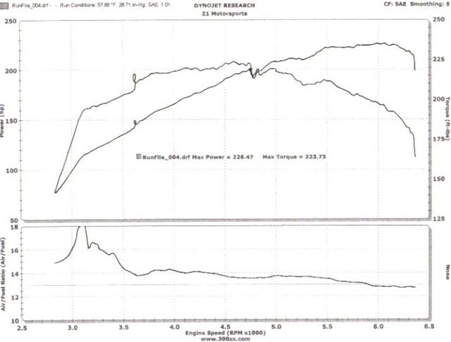

I took my Z to Z1 Motorsports this afternoon for my TopSpeed header install and got 3 dyno pulls prior to adding the headers. The mods I had at the time of these pulls are:
plenum
test pipes
popcharger
Injen dual exhaust
grounding kit
My best numers were 226.47 HP and 223.73 ft/lbs. To me, this is worse than stock. Am I assuming correctly??
Also, the 5AT is to be run in 4th gear correct??
With that being said, here is my problem. When the car was put into 4th gear and then stomped, the RPMs would climb noticably until around ~3600 RPMs and the like hesitate. They would then climb again until around 4800 RPMs and then hesitate again. Has anyone experienced this? Does anyone know what this may be or what could be causing this? One of the guys @ Z1 said it could be bad plugs or the plugs could be gapped incorrectly. What do you guys think?
The attached image is the dyno run.
Thanks for any info,
Zach

I don't think I have ever seen a dyno sheet with "loops" in the power curve. That's really weird. I am familiar with the dynojet, but I have a MT and do my dynoes in 5th gear. As far as your baseline, I think that might be on par with autos. My completely stock dyno was 235rwhp and I cant remember my torque number.

yeah what the hell is that loop? Crayon drawing of dyno? Your ecu is still adjusting for the increasing exhaust flow. You will not be able to get the full affect from the headers for about 2 weeks. Your A/F looks good after 3500 rpm. Make sure you don't have any exhuast leaks either.
another edit: Test pipes are really not the greatest thing for a N/A car, maybe putting back the catalic converters will have a better effect.

A lot of autos are pulling LOTS of timing out when dyno'd in 4th gear...
Sounds like yours is doing the same. Time for a reflash.

Yeah, but does that explain the hesitation that I am experiencing throughout several locations in the powerband???

every time I dyno with my AT5 , I get a slight hesitation in the rpms on my tack around 3,600 rpm . But it doesnt show up on the chart . I dyno on a Mustang dyno and do it in 3rd gear . We have tried several times to dyno in 4th .And just like the operator said...I lost a couple hp .

Don't know about the hiccup in the rpms, but I wouldn't trust a dyno chart where hp and tq don't cross at least close to 5250 rpms.

Could it be possible the torque converter "loses its bite" during those hesitations?

As for your numbers, the dips most likely are knock
As for your plugs, if they are stock, I doubt highly thats the answer...seems the reflash should be the next thing you look into

The equation for horsepower is;
horsepower = torque x rpms / 5250
When you make a graph of this equation like a dyno, horsepower and torque will always cross at 5250 rpms. Its not always perfect in real life, but it should be pretty close.
Your dyno crosses at 4750 rpms. That is 500 rpms below where it should be. Almost 10 percent off. My guess is that your dyno power is 8-10 percent higher than shown. So that would put you up around 248 or so. Dyno's can only be compared in relation to each other on the same car, on the same machine, under similar environmental conditions for this very reason. You may have picked up plenty of hp with those mods, but without a baseline you may never know.

if you look at the graph the reason why it does not cross at 5250 is because the scale is screwed up on that thing... on the torque side its starts at 125 and goes to 250....on the horsepower side it starts at 50 and goes to 250....get them to scale it so that they are the same
edit: how do you like the headers, i recieved mine the other day and will be installed soon...how do they sound any different also how much of a difference could you feel?
Yep, good eye.
