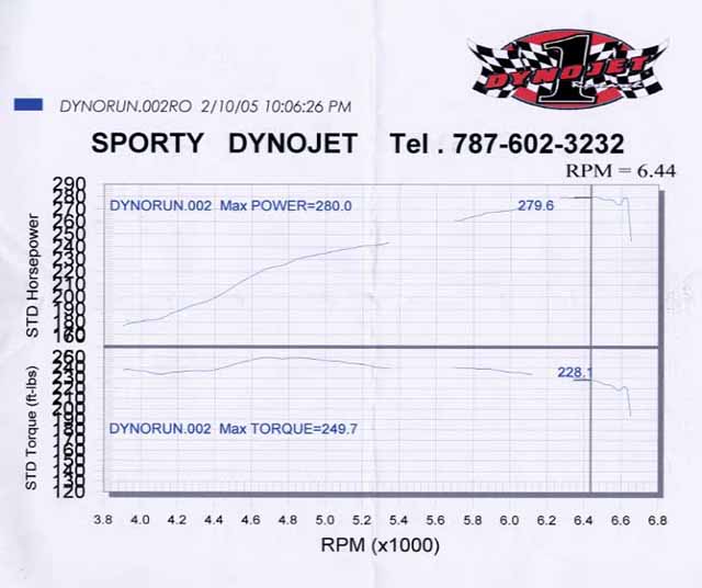

Yes, the first two I made in forth gear were 280whp and the third in fifth gear I got 281whp ... NOT Kidding...
do you have your dyno to post! that is very interesting because i heard that dyno # on the 5th gear normally read lower than the 4th!! anyways, nice to know that na mod can make some power, some of the members heresaying that they don't make power at all

I have dynoed too many cars to mention here in so many years, and the best gear is the one that is 1:1 in our case 5th. But I have seen (at least with my car and my brothers Z) that 3rd, 4th and 5th the difference in whp is not that appart, been the best 5th.
I have seen so many people here saying that there is no point in modifying the Z, because it doesn't improve performance wise. In my case, right now, racing a late model M3 is just a waste of gasoline. The last time I raced one, I pulled so many cars it was just plain pathetic. But I can't share much of my races with high performance cars here, because there are people just waiting to debate your credibility.
People, there is room for improvement… period.

what type of dyno?
I have also read that different types of dynos give different #'s.
Were those #'s SAE corrected?

what numbers were you expecting?
you don't even know the type of dyno used
If he used a mustang dyno, he'd be getting like 290-300whp even though the car is the same

They are not. If you look at the graph, it says STD HP and Torque.

Javi what were the peak numbers SAE corrected ?? My car with no headers or cams does clost to 270whp STD, Id like to see SAE #'s....BTW did you get an a/f reading?

I don't have the SAE graph, but the numbers where very close, maybe 3 or 4 whp of difference. The a/f machine didn't work.
