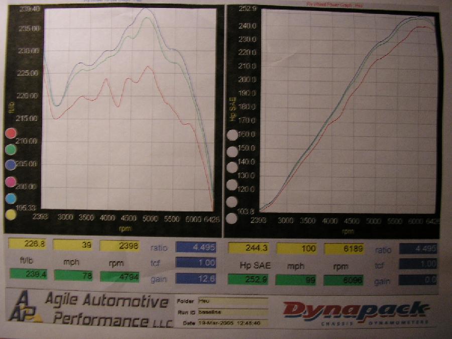

Did 3 runs on the dyno today with the Z. best is 252.9 whp and 239.4 ft/lbs. Does that sound right? I've seen a lot of other stock Zs dyno around 230-240. Also, Integrity came too (stock also) and got ~249whp.

people are dynoing all over the place
It seems like people on the east coast generally dyno higher than people on the west coast.
I've seen 220whp -256whp on stock manual Z's

My stock was 235whp and 230wtq. that was in the heat of summer in florida and 3k miles on it

Thoses are some good numbers.

Couple of things:
1) You dyno'd on a Dynopack. Those generally dyno higher because they bolt directly to
the hubs, not taking into account the loss of power from the wheels.
2) I can't tell from the pic you provided, but were the numbers SAE corrected? If not, that will inflate numbers as well.
3) What gear did you dyno in? Manuals should be 5th, auto's 4th.

What was the correction factor on the dyno?

don't forget...east coast regularly gets 93 octane vs 91 on west coast for premium.

I guess your #s sounds about right on a Dynopack?
I dyno'd my bone stock Z at 256whp and 244tq (SAE Corrected) on a dynojet
Edit: Dyno is done with 91 oct gas and 5th gear (In case anyone asks)

Here are my numbers...
249.0 HP SAE @ 6149 rpms
246.6 ft/lbs. @ 4742 rpms
We both have M6s and the runs were done in 4th gear, not fifth.
I believe the correction factor was 1.00.
Can someone explain to me how these effected my readings?

A while back, Turbo Magazine did a dyno test where the took a bone stock Z to 6 different dynos in SoCal in the same day. Here are the numbers they got.
Turbo Magazine Dyno Dash Comparison Chart
Dyno HP TQ
Dynapack 249.4 242.8
DTS 257.6 556.5*
Dynojet (Win) 235.8 227.8
Dynojet (DOS) 243.7 237.2
Clayton 265.7 240.6
Super Flow 228.9 226.6
*measured at roller without accounting for gear reduction

Ok, cool. So my numbers are right on then. So did Turbo Magazine take 6 different Zs to all of those dynos, or are all those numbers from the same Z? 228.9 to 265.7 is a huge gap.
Also, can somebody explain what the correction factor does? Thanks.

Dynapak dynos do tend to read higher.
Here in the east coast, we can get anything from 93, 94 (sunoco).. i've even seen sunocos carry 100 unleaded pump.
