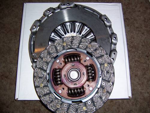

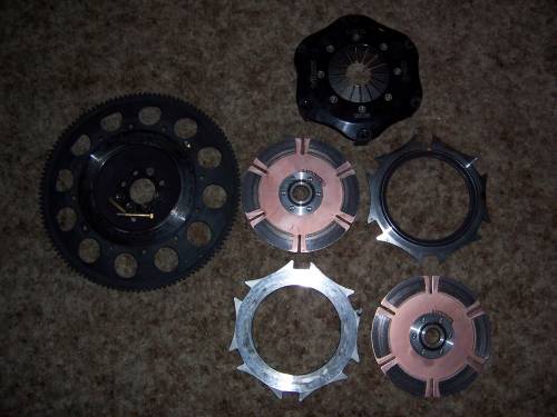

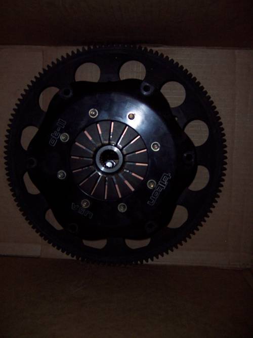

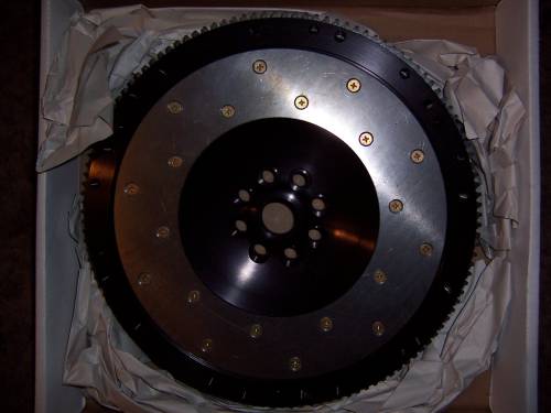

Night and day. The tilton is VERY light with a total clutch and flywheel weight of just 16 pounds and uses a 7.25 inch clutch.Tilton only works with tilton. The JWT clutch and Flywheel is like 33-34 pounds. The JWT Flywheel and Nismo clutch combo is 30 pounds. The tilton Revs VERY fast due to its weight AND diameter. But since it is so light and small, it also stalls VERY easily. The JWT package and Nismo combo are heavier and handle just like stock but revs faster than stock. Here are some pics of my JWT Clutch and Flywheel, and my Tilton set-up.
