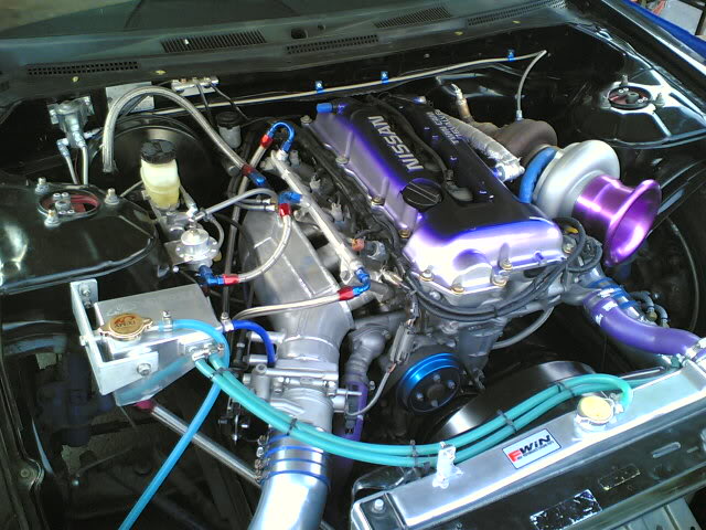

Doing a engine swap is nothing infact I could swap this in
800RWHP SR20DET
But thats not serving my purpose. For what people are spending to get real 500 and up numbers the VQ30det is a much cheeper solution.
The block is capable of over 600hp with out crazy porting, machining, and parts/labor needed to get those numbers out of the 3.5. As well it already has the fuel return built in to the injecter rails.
I have seen the numuros RB'S 2jz'Z and the SR swaps but that isnot addressing the issue of extracting big power out of off the shelf parts. Infact there is a CPU for this engine and I have seen real numbers at 375hp on the stock setup. The turbo runs out at that limit. But for the guys that have a tt set up and are looking to expand their power abilities this would be a very cost effective alternative.

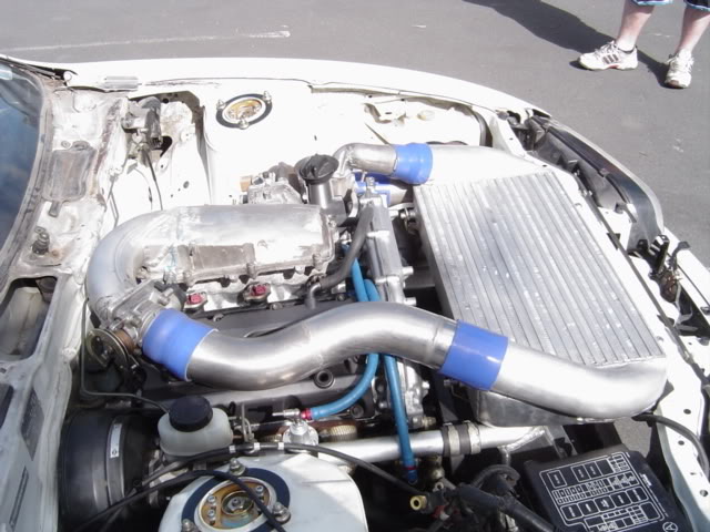

Here is one stuffed into a S chassis. He will be running a standalone on it but I would like to explore the possabilities of using the factory Z harnes and just plugging in a Fcon or a tuned ecu.
