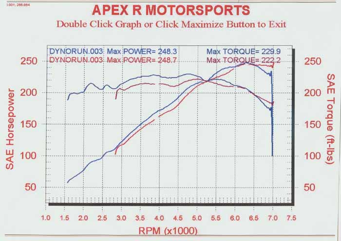

Originally Posted by Alberto
Wow dyno shows it all. Now I def wouldnt do this plenum. Look at the curve under the peak gains guys. The regular plenum out pulls it from 2800-6200rpm's hp wise, and crushes the revhigh plenum in the TQ. In a race, the regular plenum would pull harder all the way except the last second or two of ever gear, the gains isnt big enough to where the new plenum could make it up. Waste of money imo....
I agree with you.
I have a 2003 "G" 6MT Coupe.
Mods:
TechnoSquare Crawford Reflash ECU
JWT PopCharger with "Z" Tube
Crawford V4 Plenum
Crawford HiFlow Cats
Crawford Headers
Invidia G200 Dual Exhaust with "H" Pipe
Ground Wires
I dynoed along with a 2005 "G" with the RevUp motor. With no mods, he dynoed at 242 HP. We then added a Motordyne spacer and ran another. He is the red line, I'm the blue. You can see I pull him all the way till about 6300 RPM, where the lines cross. Above that I fall off, and he flat lines until redline. The red line on my reflashed ECU is now 7100.
Lou
When was the last time you were road racing someone from 2800-5000 RPM?
In a drag race, sure it might make a difference for the launch, but the wheels will spin anyway...
As I said before... The UPper Plenum makes its horse power above the stock REV LIMITER...
On a car with the rev-limiter made higher, it will be a different story...
In a race, you will be shifting from 5200-7200 RPM... Higher if you have a built motor... Our race cars go up to 7700 RPM as will mine soon...
The Super Taiku lower plenum has even shorter intake runners and is made for peak hp at around 8500 RPM...
These parts are more for HIGH RPM horse power...
On the street, you worry about lower RPM torque for passing...
2800-5000? You wrong, the regular plenum owns the 300hp plenum up until 6200 rpm's. So really even if you have a rev limit raised to 7100 your out pulling a Z by 900 rpm's all of which happen up top. Id rather out pull somebody from 4000-6200 then from 6200-7100. The wheels will spin anyway? Not if you know how to launch. IMO that plenum on a 287model Z is worthless, most wont runs cams and possibly valvetrain to be able to rev the Z high enough to maximise its potential. Im sure it does much better on the 300hp with i/e valve timing, but for us you cannot be serious in thinking it is useful for any kind of driving be it on the street, drag strip, or road course-where the added torque of the regular plenum will help get you out of corners better. If I was you trying to sell those to Z owners with regular plenums I wouldnt have posted it....
Im not talking about for a drag race...
Yes the 287 HP plenum is better for low end / mid range acceleration..
The way I drive when I race my car... I dont spend much time in the lower RPM's...
The big difference is is the car pulls hard all the way up to red-line (weither its stock or raised up to even 7700 RPM with the lower plenum on the 287 motor.. The car feels alseep about 5500 RPM when you put the 287 plenum back on... If you are in the High RPM's alot, (like when road racing) it makes a difference...
How can the car feel asleep to 5500 rpm's when the regular plenum makes more power to 6200 rpm's? I think most people that have swapped "feel" a big top-end difference because their low end and mid range suffer and then from 6200rpm's to 6600 or 7100 if they have the reflash it pulls harder, giving them a sense of "wow it pulls so hard", in reality its only pulling harder a few hundred rpm over the regular plenum. And the difference pulling harder 400 rpm's over stock redline wont make up the difference lost from 2800 up to 6200 in a drag race or on a road course I dont agree with what your saying. Dyno tells the story....
