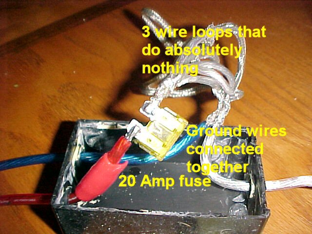

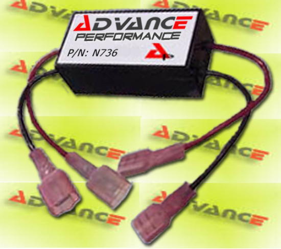

Another one of these
For the last time, DON'T BUY IT, its just a dam 10 cent fuse~
Attached Thumbnails Battery/Power-mvc-030f.jpg   Battery/Power-n736-2-.jpg
Actually I gained 37 RWHP from one of those. I had to take them off though after I blew my tires from all the extra HP.
