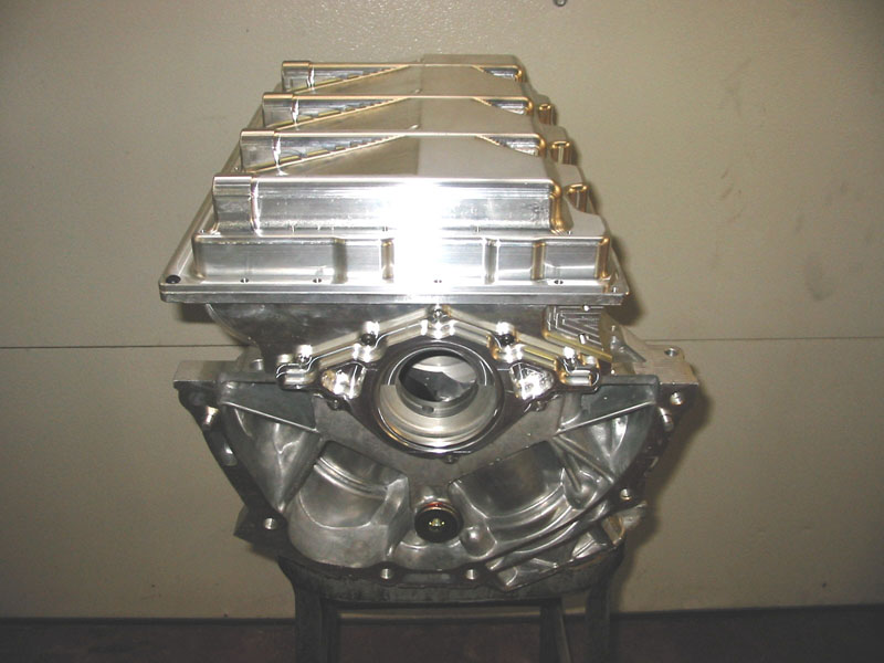

If your looking for a great shop check out this shop, http://www.westonmachine.com/ - Charlie Weston is the owner, and they're the shop of choice for many Pro teams. The work that they didn't on my block was just awesome and they are super nice guys.

How sweet is that - there are VQ35 making 2000whp with this setup!
what is that?! some kind of a high capacity oil pan? looks insane.
What?! Support this claim!

Support that claim?! Too funny...
http://www.theexperience.com/index.htm
Charlie has built their block, and they're running in the low 6's 1/4 mile - do the math... They're a handful of other teams kicking out close to 2000HP with Charlies blocks as well...
It's a girdle-dry sump system for the vq.
i bet a pretty spendy one too!!! someone forked out alot to have that made
