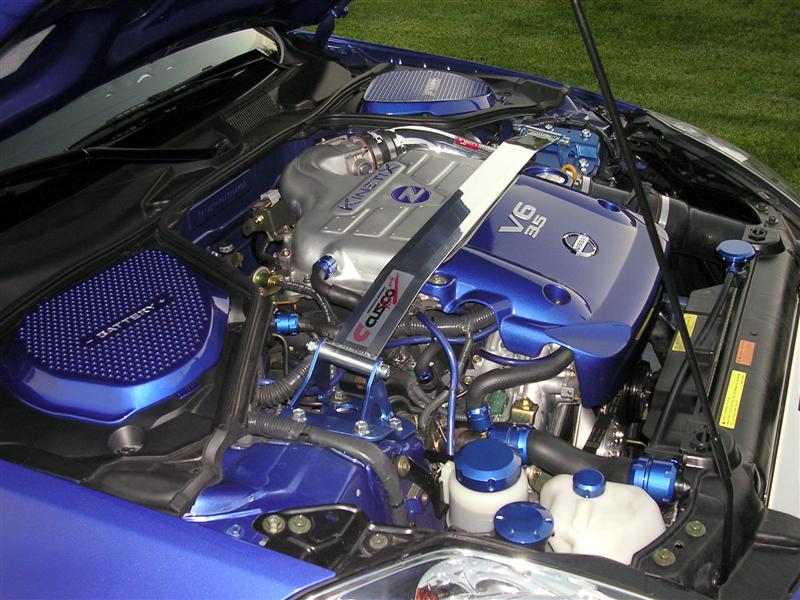

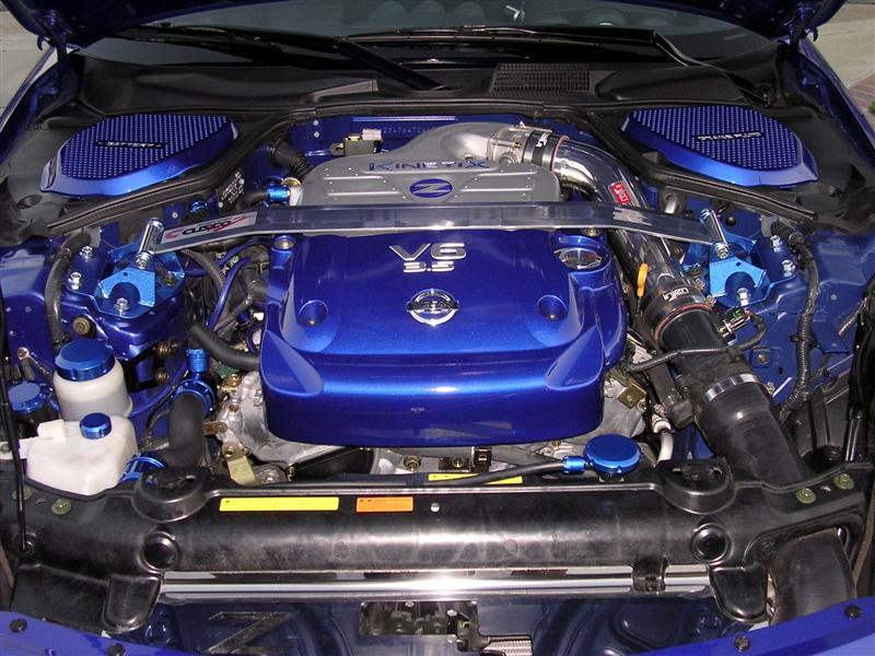

Default Cusco Strut Bar w/ Kinetix V4
Just add spacers under the strut post. I used them but it will be trial & error until you get the right combination of spacers for the clearance. Not all sides have the same amount. You can also use a clay ball above the highest point of the plenum to test hood clearance when closed. As far as the bottom clearance of the strut to the plenum you can see it from the drivers seat looking thru the hood when open. It will be close but it fits just right. Good Luck!!!
Attached Thumbnails Is there any strut bar that will fit the Motordyne 1/2" XL Spacer?-dscn1188-medium-.jpg   Is there any strut bar that will fit the Motordyne 1/2" XL Spacer?-dscn1189-medium-.jpg
