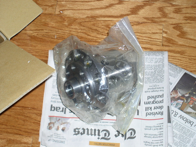

Pretty sexy... and damned heavy. Thing must weigh 40 lbs.
