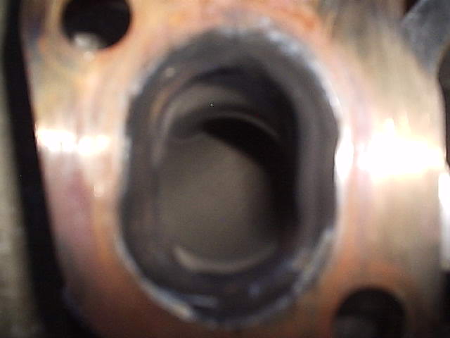

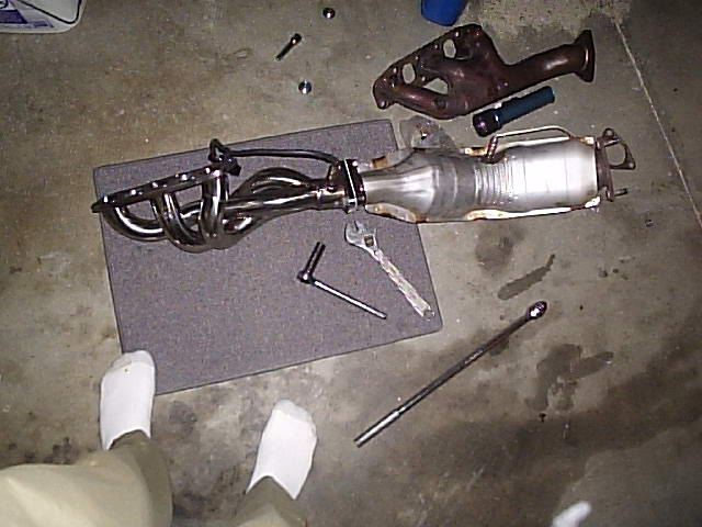

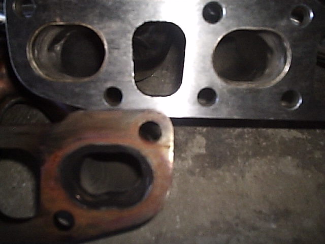

I have megan headers that i payed 175 shipped.
good quality, bends ect.
the first pics below are stock.
Attached Thumbnails Headers vs Crank pulley-p6100007.jpg   Headers vs Crank pulley-p6100011.jpg

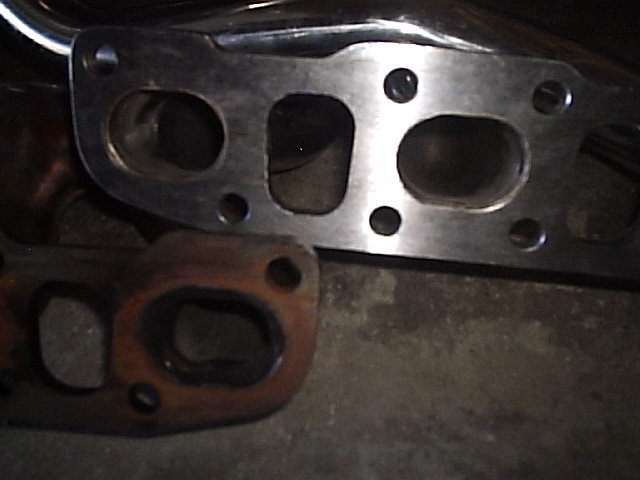

comparison of stock to new
Attached Thumbnails Headers vs Crank pulley-p6100009.jpg   Headers vs Crank pulley-p6100010.jpg

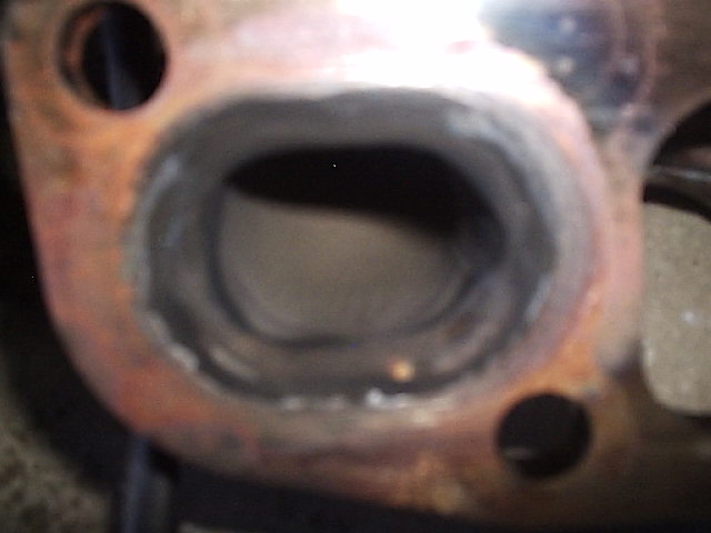

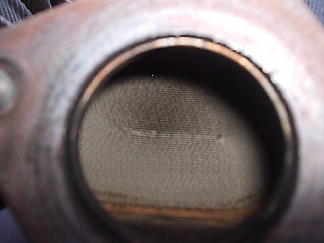

restrictive cats
Attached Thumbnails Headers vs Crank pulley-p6100013.jpg   Headers vs Crank pulley-post-7785-1133751541_thumb.jpg

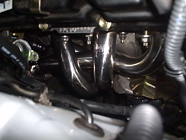

you can save alot of money doing the install you're self but it is a PITA
Attached Thumbnails Headers vs Crank pulley-p6110021.jpg   Headers vs Crank pulley-p6110024.jpg

Not starting conteversy, but just wanted to post up pics for discussion.
everyones stock headers may not be as bad as mine, i just think i had the absolute worst set of stock headers ever i mean look at those ports.
but the cats look really restrictive.
