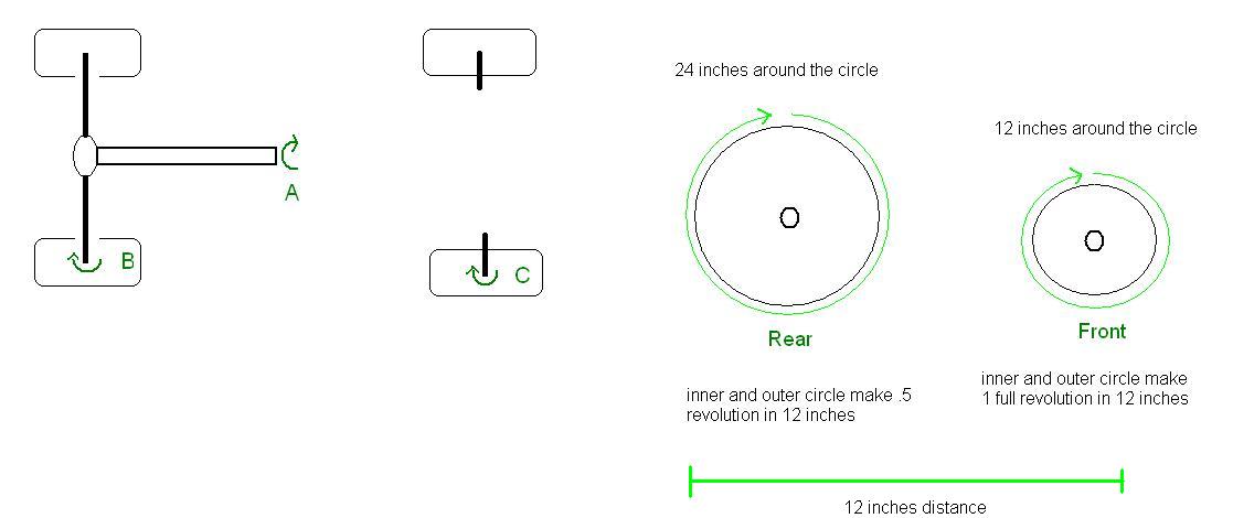

Although there are sensors at each wheels, which measures slip for VDC, Traction Control, and ABS, the sensor for the speedometer are in the front wheels. Do a burnout while not moving forward and you will see that the speedometer will not rise, indicating that the speed sensors for them are at the front wheels.
Therefore, changing the final drive gear will have no effect on the speedometer, because it only makes the drive shaft spin faster (see "A" in the picture). However, changing to bigger tires will affect the speedometer, because it reduces the revolution per distance of all A, B, and C -- going 20mph will be displayed lower.
Hypothetically, if the sensors for the speedometer are located at position "A," then changing the final drive gear will affect the displayed speed, because the shaft will be spinning faster, while the car is traveling at the same rate -- imagine the engine RPM in 2nd gear vs 1st at say 20 mph, where 2nd gear is the stock final drive, and 1st gear is the aftermarket final drive.
Now, if the speedometer sensors are positioned at location "B," then changing the final drive will have no effect on the speedometer speed, because position "B" will not spin faster or slower with a different final drive gear -- only the the drive shaft, "A," will.
However, if a bigger-diameter tire is put on the wheel, position A, B, and C will spin slower while the car is traveling at the same rate. Thus, this will change the displayed speed (see "Rear" and "Front").
Tonylltell, this is what most on this post are saying.
very well explained.. my whole thing was people say for fact it will change things but not explain how. im guessing the speed sensor measures how long it takes for the shaft to make one revolution? and if the wheel is smaller or larger then it would make sense.
i knew the gearing wouldnt change things as speed is measured after gearing. my flaw was thinking a revolution of the wheel if it matches the revolution of the axle then the speed reading wouldnt change.
understood now
