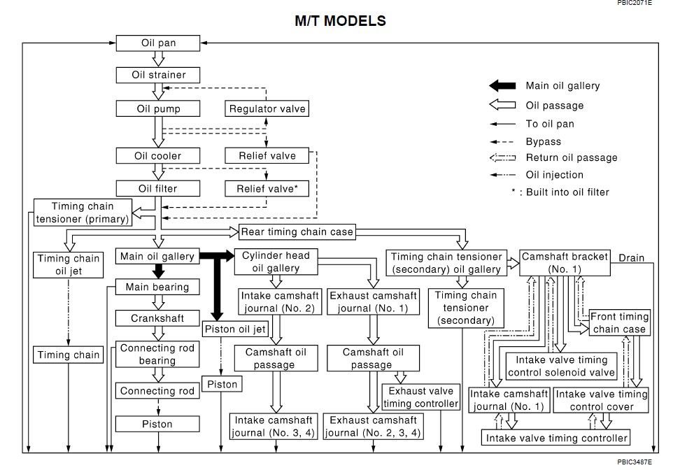

Thinking about this some more, the oil pressure sensor is located right after the oil pump. Meaning your pressure readings (from the sensor or analog gauge) are reading direct pump pressure before hitting any engine components in the circuit. I'm thinking maybe the O-rings between the upper pan and oil pump are either damaged or missing. I'm really thinking the shop who did the work on this engine missed something or made a mistake somewhere. This is all just speculation on my part, but you could have damaged/missing O-rings, or a broken/damaged oil-jet somewhere in the circuit.
Using thicker oil is a band-aid measure in my opinion, but it's better than nothing.
-Icer

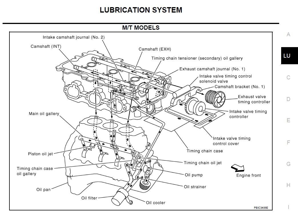

Here are some diagrams from the FSM for the various components.
Visual oil lubrication diagram
Lubrication circuit flow chart

In theory, I see Oil pressure working as a garden hose would when restricting the exit. Volume (oil pump and pick up) and restrictions to the flow.
Here is my suspicion:
With my pressure readings coming directly from the pump, before any restrictions internally, and is reading low, that implies an issue with the pump/pick up and their sealing surfaces (or an issue before oil reaches pump), right? So a volume issue, rather than a restriction, due to viscosity decreasing (from temp) and pulling in air due to poor sealing. The sealing surfaces of either the pump or pick up would cause these symptoms, if my understanding is correct.
Given the lack of VTC codes, my thinking is that even if the pump/pick up is providing reduced oil volume, the restriction through the bottom end system is still enough to maintain pressure and allow oil to make it to the top end without starvation. Do those with gallery gasket issues also experience vtc issues, since they lose top end oil pressure? If so, that would be a major clue… but haven’t come across it.
Are we sure any internal restrictions are irrelevant to oil pressure readings at the sensor? How do Z owners discover their oil pressure issues otherwise (infamous gallery gaskets)? Im left quite confused about this concept.

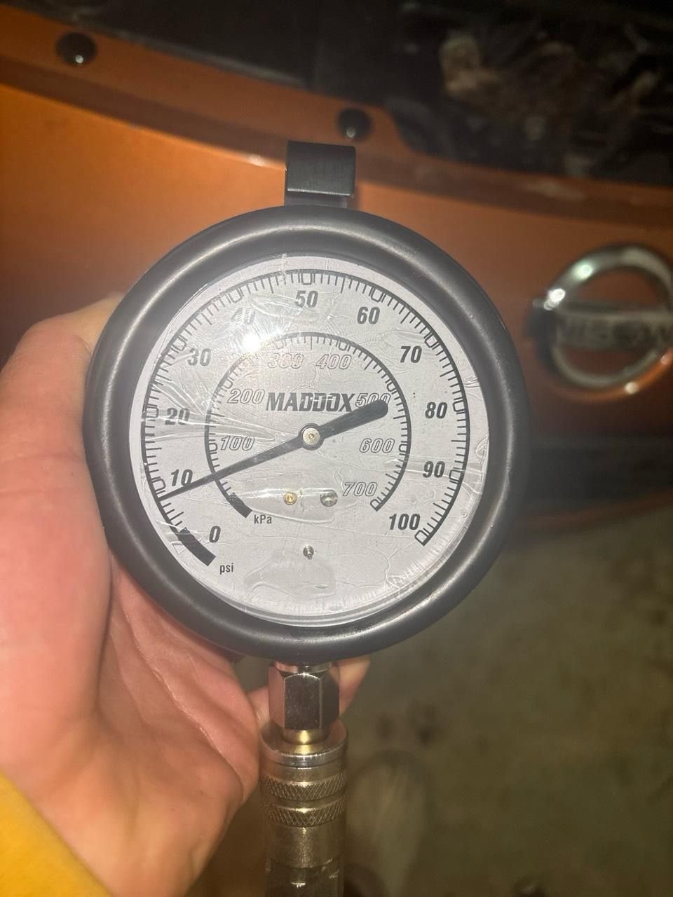

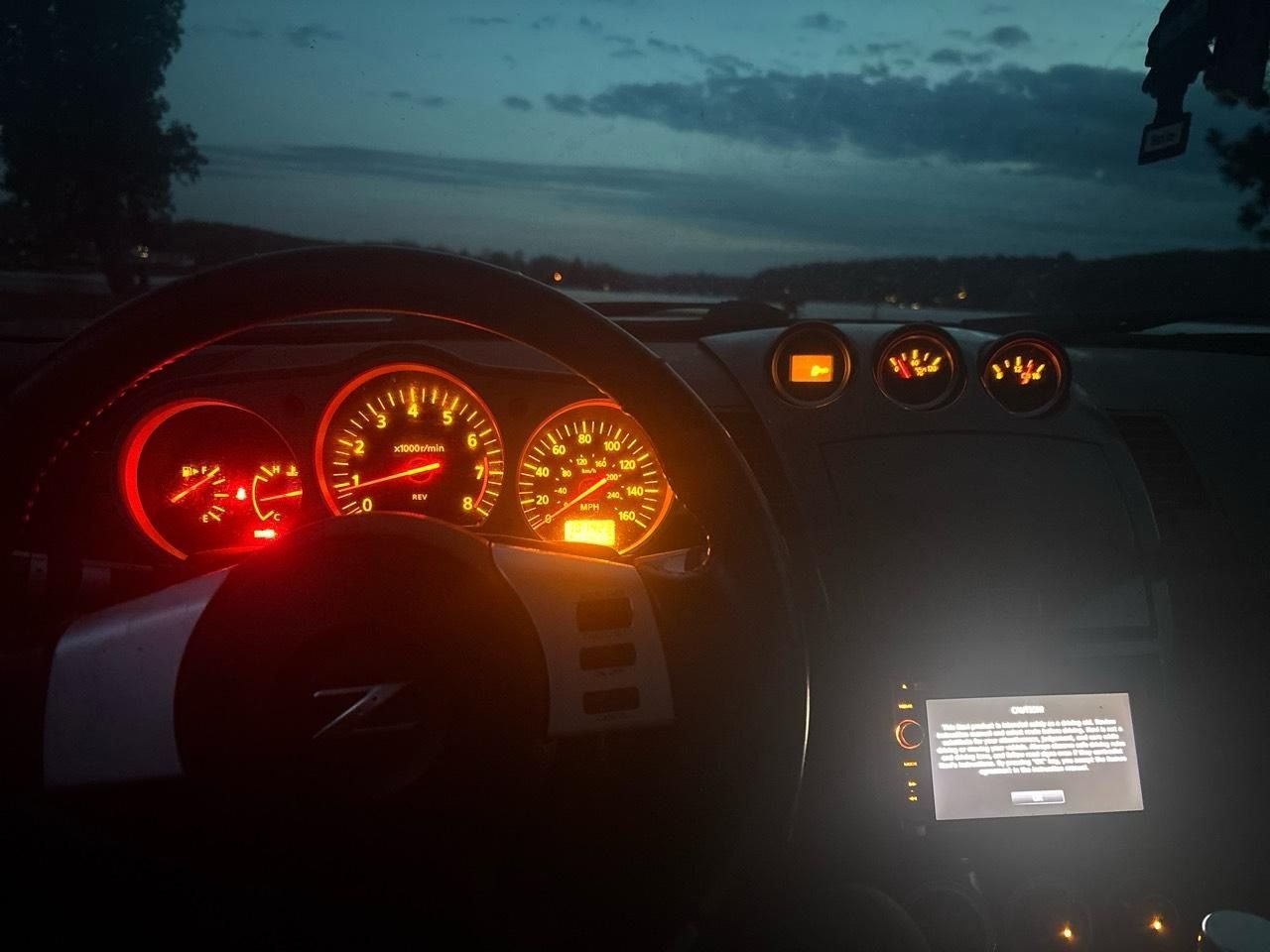

Against better judgment, I just took the car for a short drive. Got it up to temp, and the oil light didn’t come on. With the AC on (i dont have the ac belt on, so i think it just turned fans on) it put the psi right around 14 at idle. Maybe my symptoms are getting better or weren’t there to begin with.
Im considering getting a second mechanical gauge. While highly unlikely there is potential, for both my sensor and the gauge I used, to be receiving inaccurate readings.
Edit: Nevermind, oil pressure dropped once I got home and checked it. The picture above is after driving for approximately 8 minutes (I let it warm up already before driving) , shutting it off, letting it cool for 20 minutes, then turning it back on and snapping the picture.
Here is what the pressure looked like once I got home. No oil light, but it’s definitely too low:
I still question the accuracy of my readings, however, as the difference seems very drastic, no way the oil cooled down that fast when sitting to cause that big of a difference between the two pictures.

Hey Fairman,
I concur with your observations...
1st pic pressure looks normal.
2nd pic pressure seems abnormally low.

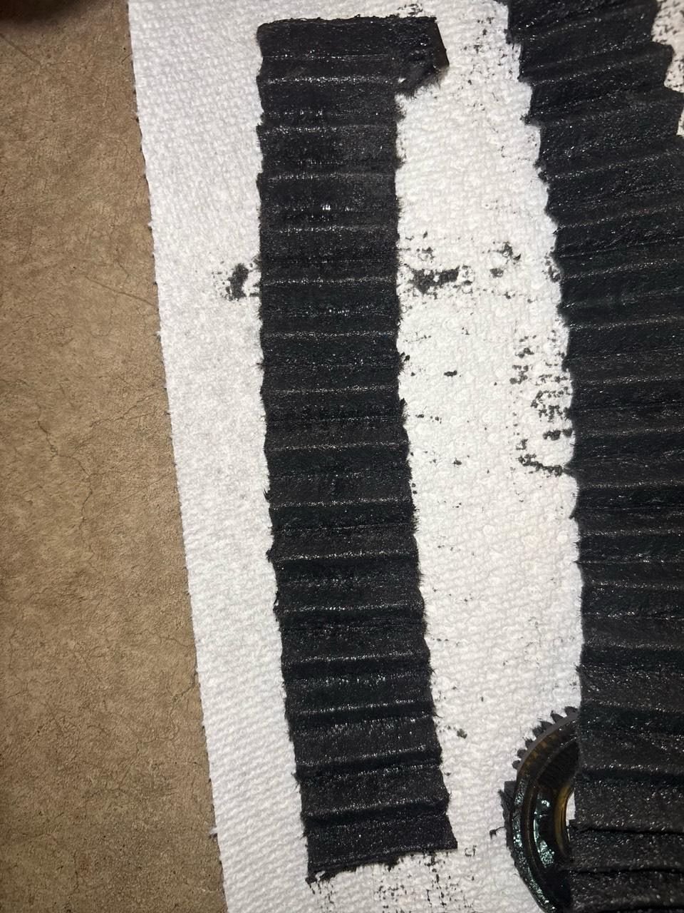

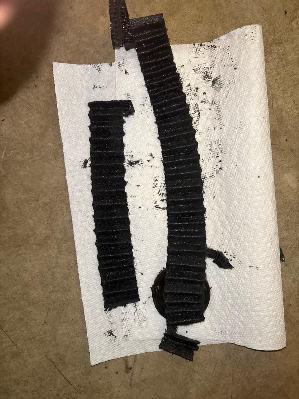

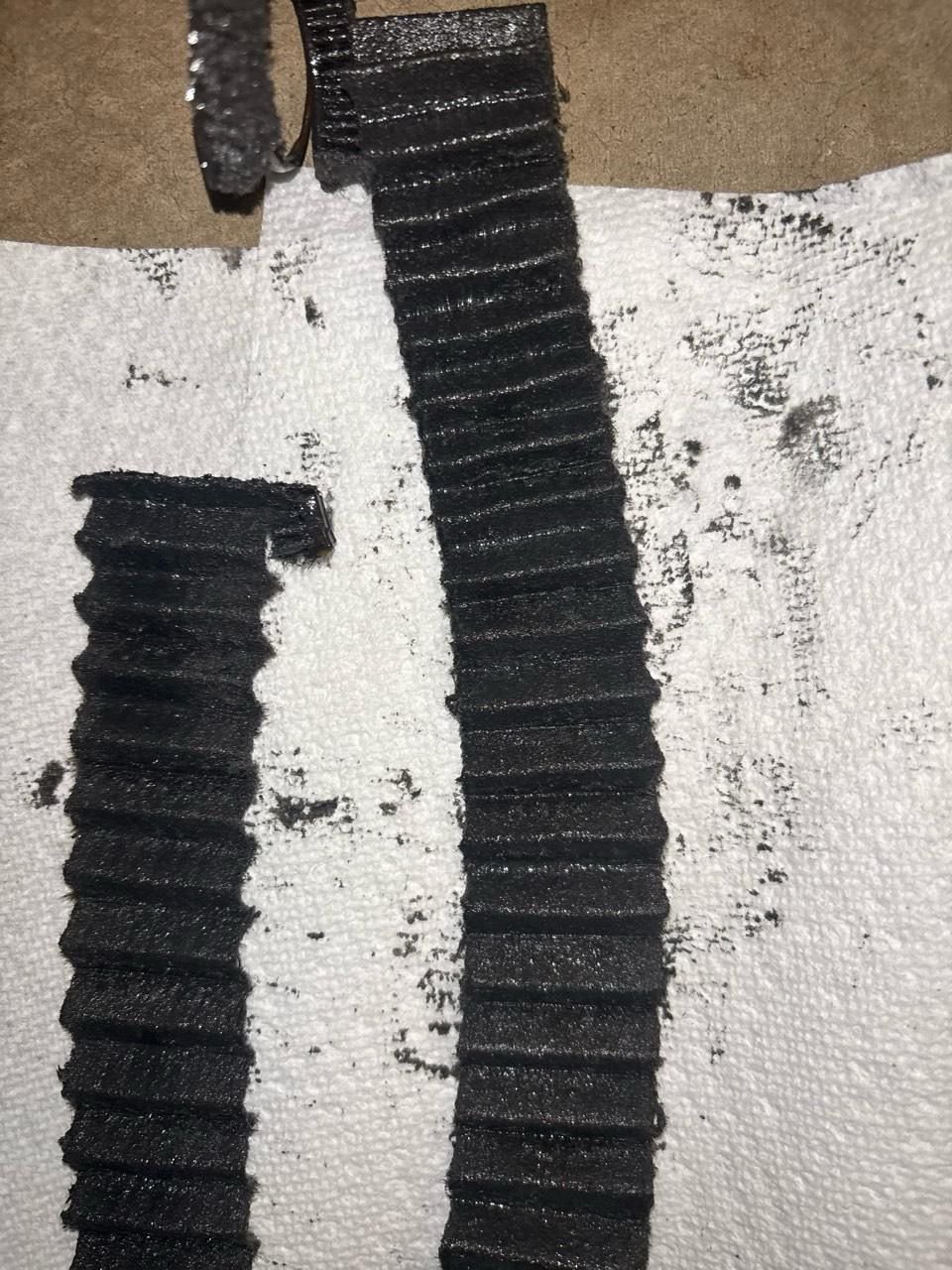

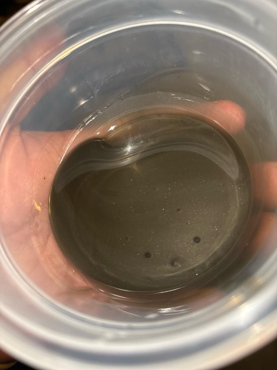

Here is what the oil filter (from before I did my work) I just cut into looked like. Approximately 50-100 miles on this oil and filter

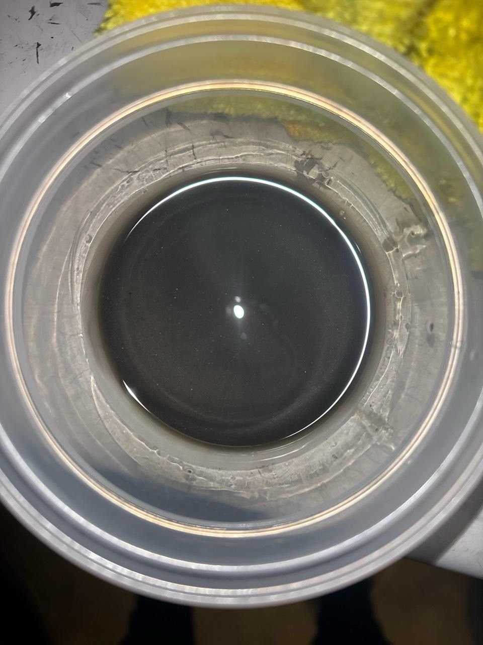

Here is what some of the oil looked like that I drained from the filter. Very silvery and glitter is present but I believe it’s nothing short of normal break in material. No chunks or nuggets were found:
After inspection, I want to conclude bearings are not the cause of my problems as I would have the material to show for it.

Yes, there is most definitely glitter present, but as you said, this might be normal break-in material. The oil is also very dark for only 50-100mi on it. This doesn't surprise me much seeing the state of the upper oil pan in your photos. This engine has a lot of deposits in it. I'm a bit shocked that a professional shop rebuilt the bottom end and never ran the block or upper pan through a parts washer, that's standard practice for any reputable builder.
Here's how I see things. Continue putting miles on it, IF something isn't right, then likely damage has already been done and you likely won't hurt it any further. But, if everything is good, then perhaps we are just over-thinking things. Once the break-in period is over and rings are seated, you should see the glitter clear up.

Here is my pressure at cold start:
Here is my pressure at fully warm operating temp (about 30 minutes of running)
I forgot to ask my friend to grab a picture of the psi reading at 2k rpm, but he read 37 psi.
I did not want to test the 6k rpm spec reading.
Some inaccuracy was present in the original test I did, but not by much. Psi fluctuates between 8-10 psi at idle with this gauge that I believe to be more accurate than the last. I definitely have a problem and have finally accepted it, grief is a ***** lol. Still a bit relieving as my original readings were extremely low.
I think both of you guys are right. With my updated readings, I think the motor will be okay with thicker oil, maybe for a while. The inevitable will happen, however, as I definitely have an issue with 3 gauges now telling me there is an internal leak.
