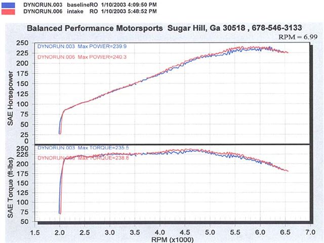

Default Disappointing results with Injen
I lost 4 hp with y pipe, flowmaster and injen, so I can't say what the culrpit is.
This is someone from another forums dyno before and after the injen upgrade, no other mods. The intake was installed while the car was hooked up to the dyno, so all the other variables were unchanged.

So what is your explanation/impression of the above dyno?
