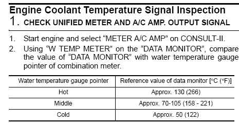

I swear the stock coolant gauge is stupid - no temp readings or hash marks or anything
So it goes from cold to hot and usually sits somewhere just under halfway when driving. So how hot is the coolant if it reaches "H"??
What about the hash mark right before "H"?
Just trying to figure out if Hot means 300 degrees or 280 degrees or what. I'm debating getting an aftermarket coolant gauge

This is about as close as I can get you....
Attached Thumbnails anyone know the readings of stock coolant gauge?-snap.jpg

cool thanks
