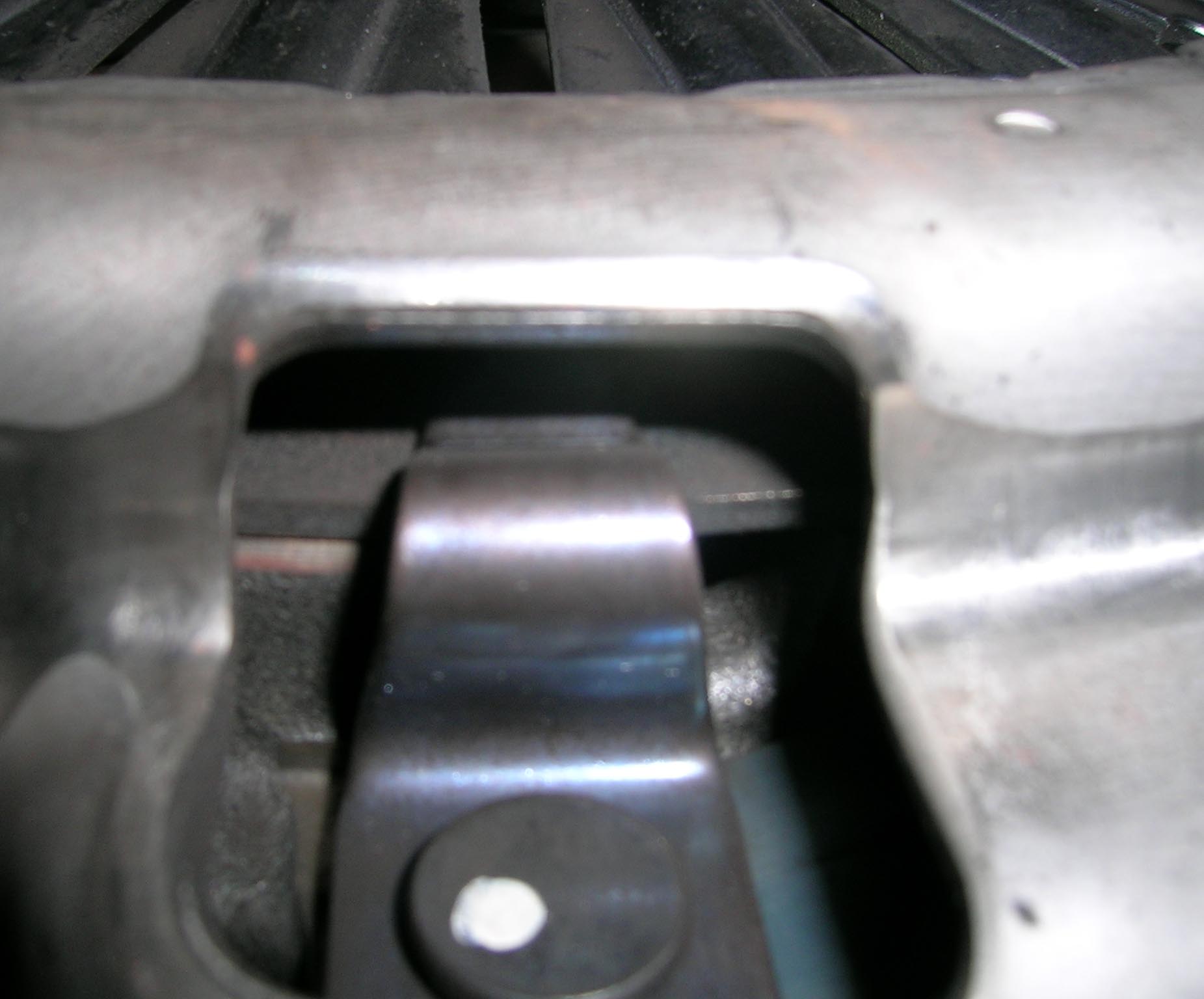

Old Mar 6, 2006 | 09:29 PM
punish_her's Avatar
punish_her
Posts: 2,386
From: Bellevue, Ne
Default pictures
ok here we go.... Good clutch. Notice (except for finger prints) no glazing no hotspots absolutly no signs of abuse. Been in less than 1K miles.
EDIT: the friction surface is the back side of the clutch that failed.
Attached Thumbnails broken pressure plate fingers-good-clutch.jpg   broken pressure plate fingers-goodfinger.jpg   broken pressure plate fingers-goodwidefinger.jpg   broken pressure plate fingers-friction.jpg

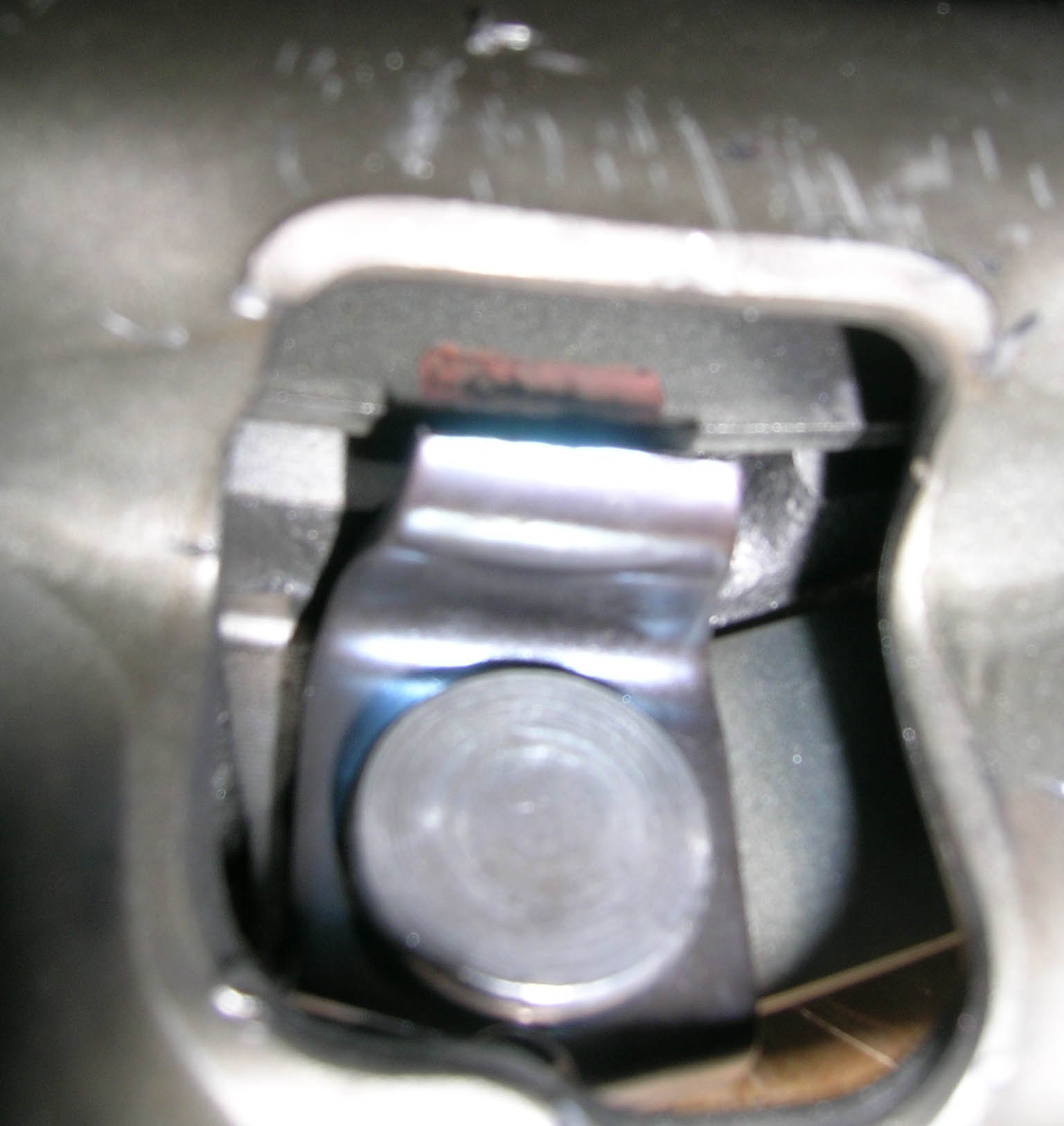

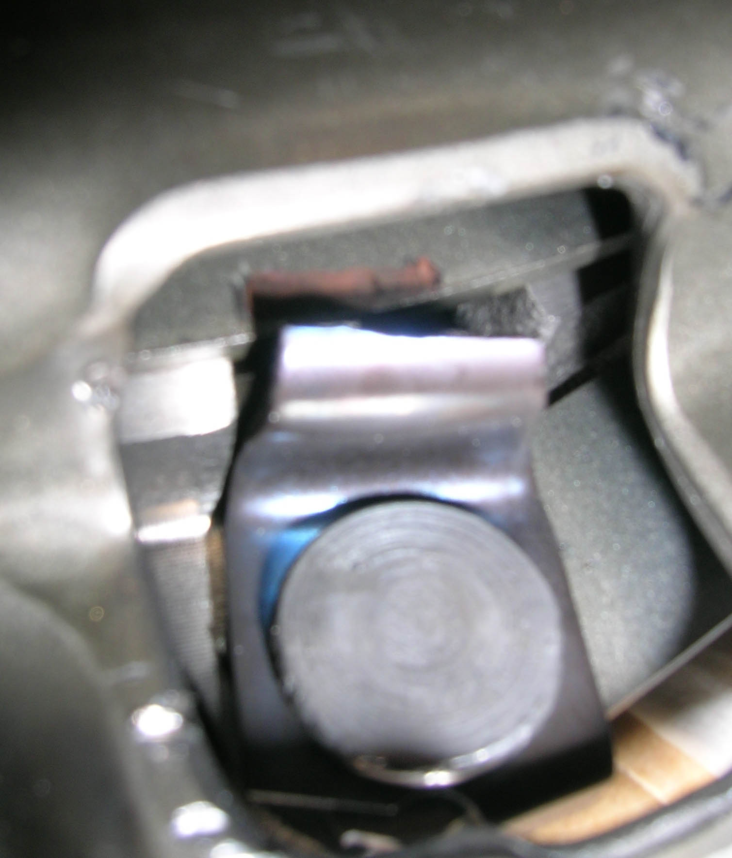

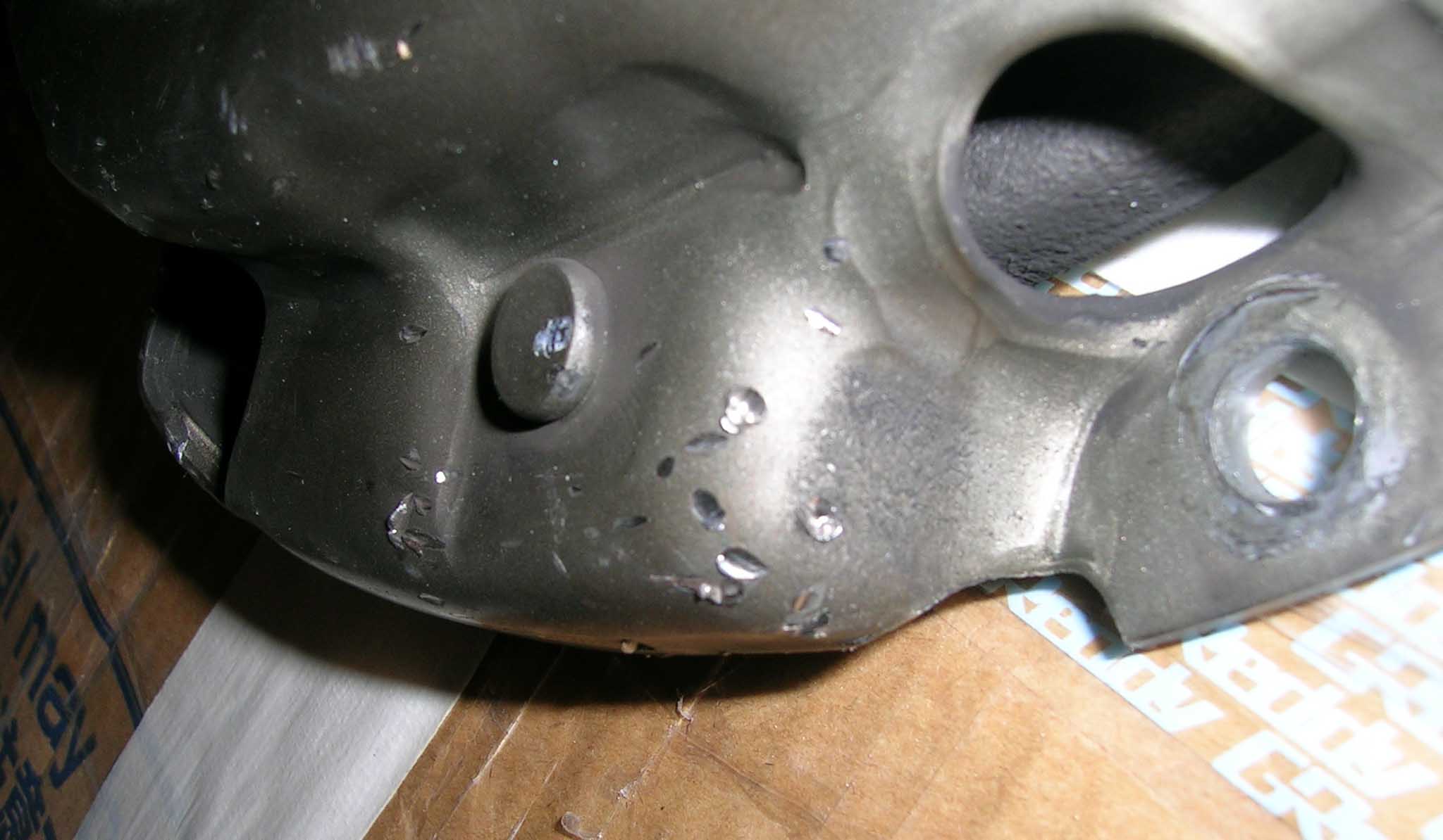

Old Mar 6, 2006 | 09:36 PM
punish_her's Avatar
punish_her
Posts: 2,386
From: Bellevue, Ne
Bad clutch.... The technician and I stated a little differently. It wasnt the throw out fingers. It was the retaining fingers for the friction surface. There are 3 fingers on the front side of the pressure plate. All 3 parts were broken. One sheared like a twist. WTF!!!!
Any one tell me how is this possible on a stock engine, less exhaust, with less than 1K on the clutch? Any One?

Old Mar 6, 2006 | 10:42 PM
JETPILOT's Avatar
JETPILOT
iTrader: (51)
Posts: 6,319
From: Vero Beach, FL
If your going to be driving the car on the street you should really think about sticking with a twin carbon clutch. I have a brand new ATS twin carbon clutch for sale with the 1350kg pp good for 765 rwhp if your interested for a good price. Even if your not interested in this clutch stay away from the triple you will regret it and it's overkill for 650rwhp.

Old Mar 8, 2006 | 07:09 AM
Jay'Z's Avatar
Jay'Z
iTrader: (118)
Posts: 10,944
From: Carbon Fiber, TX
what causes that is bad shifting engagement + bad clutch ....... sry bud

Old Mar 9, 2006 | 03:12 PM
sa52's Avatar
sa52
Joined: Jan 2005
Posts: 33
From: Miami
I had this same problem happen to my JWT clutch as well. I found out after my I took my car in to get my transmission replaced for the infamous grinding problem. Well I sent pics of the broken clips over to JWT and Jim Wolf himself called me later in the day to assure me that the clutch can be reused. He explained to me those clips are used during installation to line up and hold everything in during the assembly of the pressure plate. He said some clutches he builds do not even have those so they are not needed. He said the onlything to worry about was if all 3 of the clips were not off that it might cause an imbalance but mine were all gone. He even told me that I could send it back to them to have it rebuilt but I need my car and couldnt get away all the down time. He also explained that it could have happened that the plate got overextended and broke the clips off. JWT has great customer service.
Yeah but those clips chewed up the clutch cover and fly wheel some thing bad. Like I said before, there is no way it could have been over extended. unless they are not rated higher than stock.
In any account I went and bought a new 6 puck pressure plate and clutch plate there's no way I'm putting a broken pressure plate in the car after its gonna be 420-430 at the wheel. The car should be out of the shop tomorrow. so yeah looking forwar to see how the new clutch feals.
