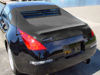

Carbon fiber pantera style rear hutch will loose you more than 50lbs.

"Carbon fiber pantera style rear hutch will loose you more than 50lbs.
https://my350z.com/forum/attachment....&postid=172799"
posted by vlad
i hope you aren't planning on getting this! it would turn your car into a fiero! or maybe even an IROC! that thing has to be the worst rear hutch i've seen! no offense to you..but i think it's pretty nasty!

What you expected from 5 minute photoshop? That was just to show the idea. Real thing could look much better, and be color-matched.
Yes, I'd get it if somebody will produse such a hatch.

cool photoshop...good job on it...but why not keep the window? why put on the vented slot look?? if you are going for the "take out the heavy window" idea....why not put in a smaller one (like the Z3's have) instead of that vented look?? could be nice...would need to paint it of course...but my $0.02 is to get rid of those vents....looks too 80's. (not taking shots at you...just my opinion).

the change in hatch design eludes me. you could reduce the weight just as much by replacing the metal with carbon fiber, and the glass with plexiglass, car appears identical to stock, and loses alot of weight.
sadly that plan wasnt really thought through, since theres a strut bar there, meaning you cant drop the trunk down.
Id bet no one here would want to drive around in a car that had weight removed, the weight is in the things we enjoy, the trim, stereo, AC, HEAT, Power everything, ect. if you want to lose weight, remove all of this. personally Ill accept the weight, and maybe try and remove some through mods like integrate listed.

yes, small window to save weight. Size and angle on picture is optimal (minimum weight) to keep current field of vision.
Louvers is an idea. Unlike most bodykits they are functional. Since sun from the rear could be problem when window is so close to the driver. On the other hand you can just tint the window.
Ares, I don't see what you talking about. Strut bar isn't problem at all. Hatch WILL clear it. Remember, that it's goin to be very thin - no plastic panel on inside. And it'll have some slope in it. It's not parallel to the ground. Otherwise window will be too big. Probably the plastic panels around strutbar will go. I don't mind - if it's not seen, I don't care.

Hey Vlad, I see you like that design check this out...
http://www.arizonazcar.com/decks.html
Arizona Z cars 280Z pantera style hatch
I bet if there was enough interest Dave would look into making one fot the 350Z, maybe out of CF.

Yes, I've seen it. And I like it a lot. That was one of the prototypes for my simulation.
The problem is that one was BONDED to original hatch, so no real weigh savings was there. In case with our Z, hatch is much bigger surface/metal amount. So weight savings could be huge. I don't see any technical difficulties of implementing it. Hope somebody will eventually do it.
