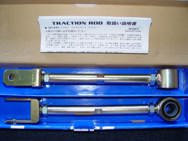

hi wadd 3456,
here is a pic of the jic rear traction rod
Attached Thumbnails my jic flt-a2 coilovers and rear camber adj. link  r installed-nissan-350z-010.jpg

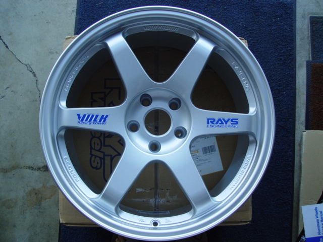

oh yeah guys,
look what came in today.
too bad only the 19x8.5 fronts came only.
still waiting for my 19x9.5 and 19x10.5.
oh well.
talk to you guys later,
john
Attached Thumbnails my jic flt-a2 coilovers and rear camber adj. link  r installed-nissan-350z-009.jpg

Cool, thanks for the pic. When you get a chance (i know you said when its up on a lift ) shoot a pic of that camber whohaa.
Cars looking great !
PS- what did the camber thing cost ya?

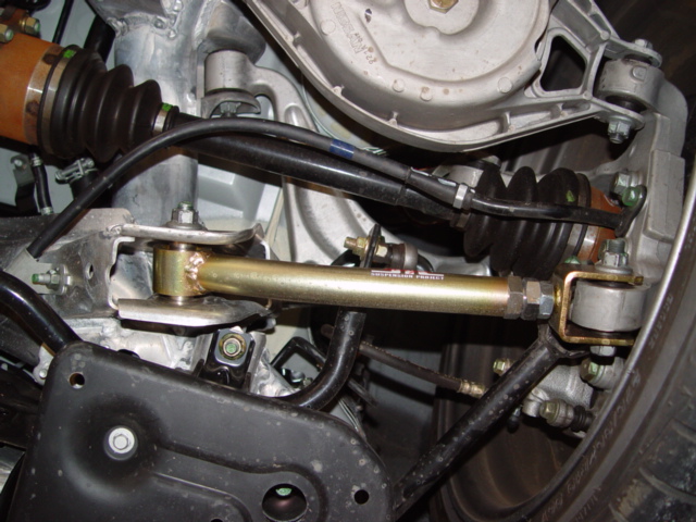

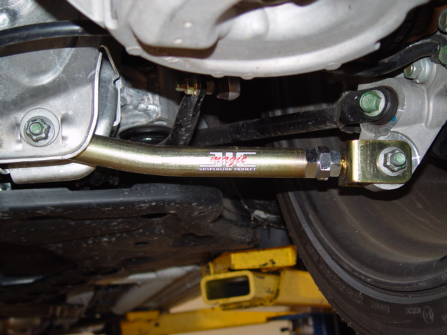

hey wadd3456
here's the rear camber rod pix
here's pic 1
Attached Thumbnails my jic flt-a2 coilovers and rear camber adj. link  r installed-2nd-nissan-350z-007.jpg

here's pic 2
Attached Thumbnails my jic flt-a2 coilovers and rear camber adj. link  r installed-2nd-nissan-350z-008.jpg

Looks like it pulls the BOTTOM of the wheel in huh? Most camber setup push the top of the wheel out.
Old Feb 26, 2003 | 05:36 AM
john350Z's Avatar
john350Z
Posts: 1,223
From: sactown, cali
hi wadd3456,
i am not a suspension guru. you know way more than i do.
the only thing i know is that it is adjustable in 2 places.
in the first pic:
1) there is an adjustable offset bushing to the left. you can see in the middle of the offset bushing that there is a dot for center, i believe.
2) there is an adjuster on the camber rod also, to the right.
hope the pix help in your project.
talk to you later,
john

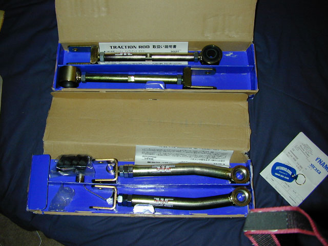

the camber rods adjust camber of course, the traction rods adjust toe. i'm getting them installed in about half an hour.
Attached Thumbnails my jic flt-a2 coilovers and rear camber adj. link  r installed-cambertoe.jpg
Old Feb 26, 2003 | 08:27 AM
john350Z's Avatar
john350Z
Posts: 1,223
From: sactown, cali
hey 2k3silver350z,
i have the traction rod, but didn't install yet because you have to drop the rear subframe in order to get that big bolt out.
anyways, if you guys did it without dropping the rear subframe, let me know.
have fun and good luck on the install.
john350z

Originally posted by john350Z
hey 2k3silver350z,
john350z
heh well everything besides one of the traction rods was installed. JIC forgot 2 of the metal pieces that go into the end of the rod which freaken sucks ***. as of right now all of it is on there. i didn't personally do the install a local shop did it and as far as i know they didn't drop the subframe out. they put the car onto the lift undid the bolts and put the pieces back in. the camber/toe looks a lot better. i can't freaken believe how much negative camber there is stock. i've already gone through a set of rear tires as a result. i'm going back satuday if the part gets to me on time. it's sleeting and pouring down freezing rain as of right now so hopefully that will clear up.

hey 2k3silver350z,
what is missing from your traction rod kit?
i'm looking at my pic of the traction rods and your pic, and it looks like there is nothing missing. just 2 rods.
also, can you give me the name & # where they installed your set-up.
let me know and thanx,
john
Old Feb 27, 2003 | 08:36 AM
  #39
2k3silver350z's Avatar
2k3silver350z
Posts: 479
From: knoxintheville
there's a local firestone that does anything and everything with suspensions since no one else here will. i've dealt with them a few times before.
(540) 344-6218
as for the piece that was missing it was on the camber kit. it's the two metal pieces that go into the end of the rod. they forgot one set and only gave me two instead of four. so right now three of their bars are on and one is off untill i get the pieces. i didn't realize how bad our camber on our cars is until we adjusted it. the car feels like it rides better also.
