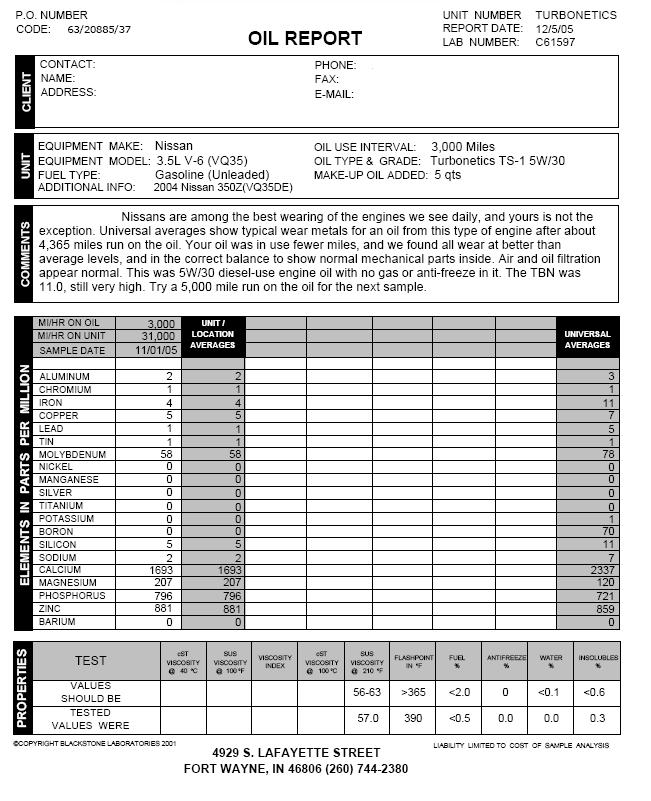

I ran Mobil 1 for a while and was losing at least 1 quart by eahc oil change. I switched over to Royal Purple for a while and burned a lot less but my valvetrain got very noisy. After that I went with Turbonetics TS-1 oil and valvetrain went back to normal and I stopped burning oil. I also ran an oil analysis on my car after 13k miles of using Turbonetics oil... I'll attach it here.
File Type: pdf
Good info.
It's nice to see "U.O.A." instead of "B.S."
Here's mine, 5k miles on some pennzoil from the dealer.
No real problems. Note that it is still showing initial wear even at 10k miles.
Maybe some of you guys burning synthetic simply switched too early. I will switch once I see that my engine is totally done wearing in.
