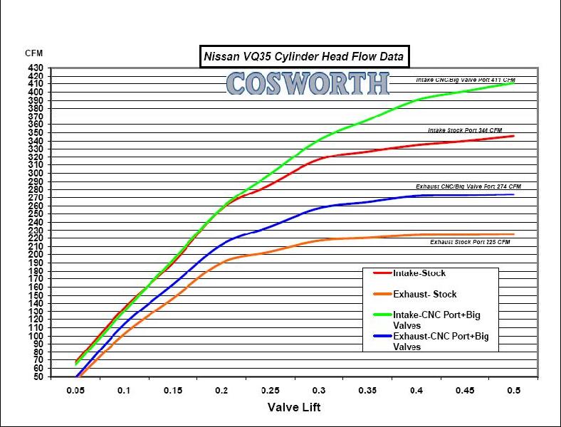

Here is the only Flow chart i have seen that shows what the stock heads flow. It also shows what the cosworth heads flow.
Hope it helps

344 cfm is more than enough for the lift of cam i am using. Hell a 16 valve volvo head fully ported flows 260 cfm and is good enough for 600hp on a 4 banger.

Without knowing what inches of water the heads were flowed at that chart is useless. If it was higher than the standard 28" the numbers will be inflated. If those are 28" numbers I don't see these heads really needing port work.
