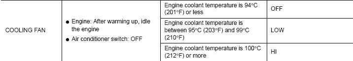

Does any one know at what temps the low speed and high speed fans come on at ?
I had the shop put it some slim [flex-o-lite] fans in and I think they may have them wired to come on at only the high temp setting only.

From the FSM..

Thank you Sir !
