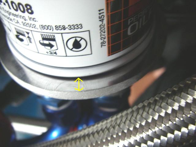

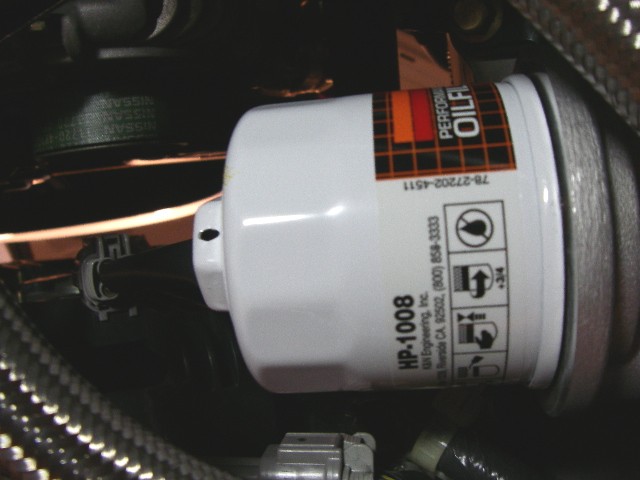

Last night I picked up some 6 qts. of Mobile 1 0w-40 and the K&N HP1008 filer. The K&N was the same diameter as my previous filer that fit on the OEM location and threaded on wobbly also. In the end though, when I tightened it down all the way. It provided a good seal that did not leak.
In the picture below you can see(yellow arrow) the gap I was concerned with. The rubber seal on the filter sits right on the edge of the inner lip of the ARC mount.
Attached Thumbnails Project ARC..Engine bay build in progress..-b1.jpg   Project ARC..Engine bay build in progress..-imgp2605.jpg

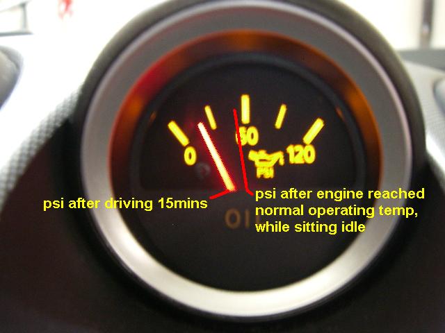

The car took 5 1/2 qts of oil. Not a big increase from factory levels. After starting it up, I let it run for about 10mins or so to reach normal operating temp. I did not drive the car, I just let it run idle until it warmed up. In the pic below the red line indicates the psi the engine leveled out to after it warmed up in the garage.
After it warmed up I took it out for a test drive. After driving under full load for about 15mins, you can see the pressure dropped even more.
I've also included a pic of the temperature after the tst drive.
Attached Thumbnails Project ARC..Engine bay build in progress..-b2.jpg   Project ARC..Engine bay build in progress..-imgp2609.jpg

One observation I made while driving. There is audiable engine whine now that wasn't present previously. I am not sure of the exact cause of this, but suspect it to be the new grade of oil I am running. Theoretically I'd assume the engine would run more quiet on account of the 0w-40 having a higher vicosity than the 5w-30 after reaching normal operating temp. This isn't the case though. The engine whine has me wondering if I made the right decision to go with 0w-40. As previously stated I'm not an afficionado on engine oil, I research as best I can then try to make a sound decision based on what I read.
A couple other post observations I made.
1. The oil cooler gets extremely hot.
2. You can hear the oil cirrculating through the cooler if you stand infront of the car. It sounds kinda cool.
I'm wondering what the impact would be if your driving on a hot day, the oil cooler gets to it's normal hot condition, then it rains all of a sudden? Everyone knows cooling very hot metal really quick can cause it to crack or warp.
Please comment on what you guys think.

Just so you know Vo, your oil PSI at idle after a complete warm up (driving for 15 min) is what my car has also had ever since I've used synthetic oil, so I dont think it's a problem at all.

Thanks guy. It's pretty close to what I had prior to the install also. It's funny, because when I 1st started the car there was no pressure. All i heard was this gushing noise, then the pressure rose. It was the oil cirrculating through the new lines.
