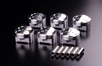

Wow, really high compression pistons for those who want to stay NA. No idea on gains, but damn they look sweet.
http://www.streetsports.com/Tune/350Z/Esprit.htm
just scroll down on that page.

Very sweet pics, thanks.
Wish I knew some gains.

I have heard that on smaller displacement motors (3.5 L is more a mid sized motor IMO) each point of compression is roughly = to 10 hp, so if you go from 10:1 to 11.5:1 you gain 15 hp in theory, although asi mentioned, bigger motor may = bigger gains.

You could probably get a piston set from JUN, JE or Tomei for a lot less than what Esprit is charging.

I was excited to see the pistons, but then that died upon seeing the price. Ross, JE, or even Young Racing, would make a CUSTOM set to ANY spec for HALF that price. But it's kewl to see they made some, they're paving the way for others to do so as well.
I'm digging that rear spoiler that they're offering though... I think it goes well with the rear curves of the car.

Keep in mind that just raising compression isnt a freebie mod. On stock cams and pump gas your knock sensor might just retard so much you'll end up losing power also, any ECU mod will be taking the stock commpression into consideration.
