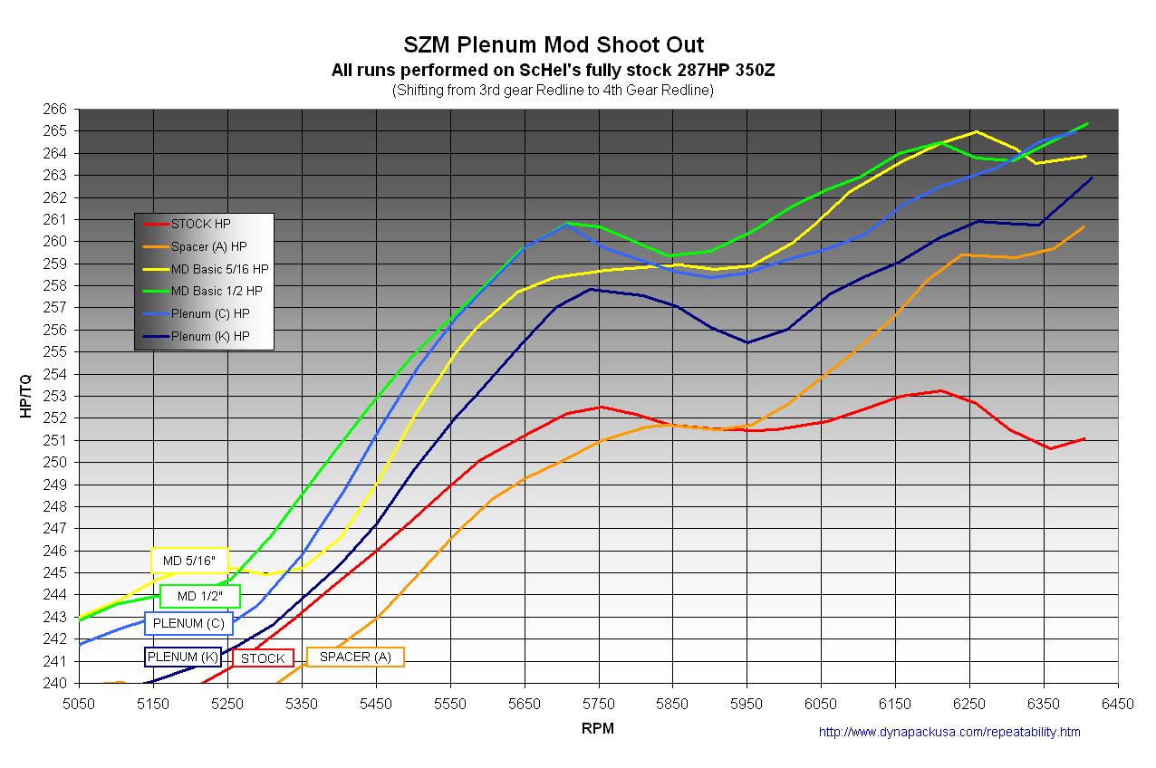

Seems like this is a great mod, from the dyno I found it shows higher gains with the "MD Basic 1/2", while it seems that most of you have prefer the "MD Basic 5/16" or something similar its size. Why not use the 1/2? Is this dyno off?
Also is this something you can do yourself on a side street? I live a block from Ravens stadium in Bmore, but theres really no traffic on the street..
Looking to get this done as part of my first upgrades, so far I got the pop charger and Im ordering the exhaust on Friday, so I just wanted to see where to go with the spacer...

1/2'' iso thermal spacer...doesnt work with stock strut bar so you will have to take it off and buy an after market one. either way theres only one HP difference.

that makes sense, not worth it for now...so I assume you can put the 5/16 on without making other changes?

I used 5/16th" because it fits, and you dont have to remove strutbar or get another one. Besides, I think the gain from 5/16ths to 1/2" is like 1 whp. Not worth losing the strut bar or having to mess around with things to get it to fit.
