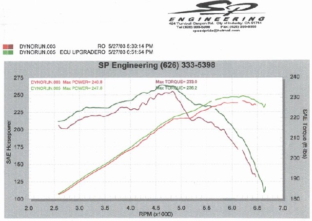

Hello Guys!
well, here are some DynoJet Graphs that i promised a while back... these are DYNO JET-brand dynos, which often companies take as the 'baseline' measurements...
First graph shown here is a BONE STOCK Track 350z (i.e. Stock Cats, Stock Ypipe, Stock Airbox, Stock Exhaust) in the color RED and then with ONLY the ECU modification in GREEN...
From closer inspection of the Red versus Green, we have a PEAK horsepower gain of roughly 7hp at 6200. At 5200 rpms, we have a gain of over ~12 hp and very strong torque gains over stock all the way to redline.....
i must emphasis again, this is just with the ECU modification alone (the ypipe and test pipes were removed and changed back to stock...)

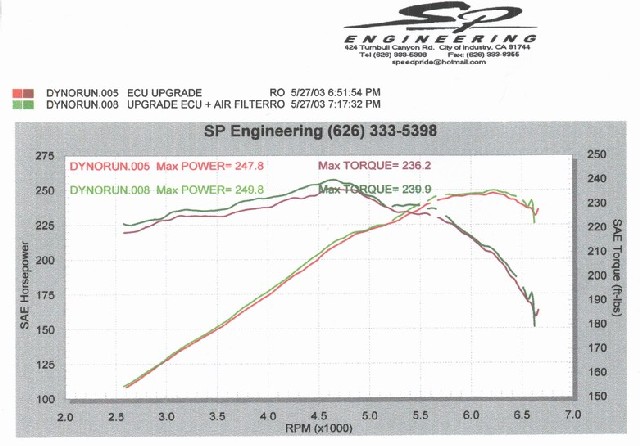

This graph will show the differences in just adding a simple velocity-stacked intake (similar to the JWT pop charger) that we made in house as a test..
RED is the 350z Track with ONLY the ECU as the modification, and the GREEN line is with ECU AND Intake.
From closer inspection of the Red versus Green, we have a PEAK horsepower gain of roughly 2hp at 6250. and a gradual gain throughout... but a moderate torque curve throughout as well..
Time ran out at the dyno, and we will pull again with the Test Pipes and Ypipes as addons...

Cheston,
Thanks for the graphs and info! The additional torque looks great...spread everywhere. The torque gains towards the top end are particularly impressive...looks like 20lbs difference at some points from 5k-6k rpms! That will make a big difference on the top end accel. I can't wait to see what happens with the other mods.
I have some questions though.
1. I saw that you mentioned test pipes and Y pipes, but no mention of exhaust. Will you be testing an exhaust(s)? Will dyno runs be done with each of the mods in isolation? The reason I ask is this: I think most people are not averse to adding a Y pipe and exhuast, but a lot of people probably won't get rid of the cats...want to stay legal. If at all possible, please do runs with the aftermarket exhaust and Y Pipe, but with stock cats (or high flow).
