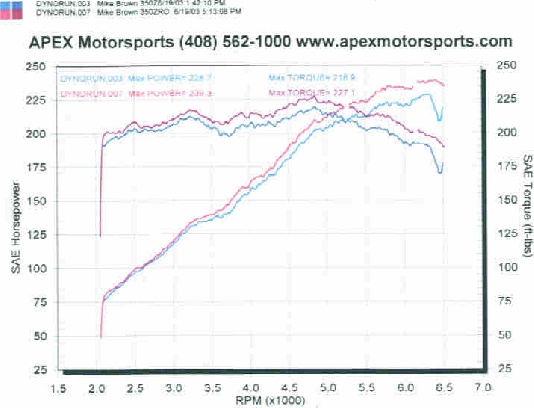

Why was your Dyno graph only run up to 100 mph? Surely that can't be 6600 RPM?
I had my Baseline Dyno done and I know the Speedo registered in excess of 140 mph...
(OK I may have now realized that this was done in 3rd gear and could be the reason for the low speeds. I'd like to see a HP and Torque curve vs. RPM not speed)

I am by no means a duty expert on dynos at all. As a matter of fact, I've never had one done. I would expect that they could get the date right though!! However, if this date is correct, then none of this make sense to me.

what's up with those dates? Damn, the first pull numbers are pretty low.

That's not really a big deal. If the computer running the software has the wrong date (which it might being that many of them are old and their clock battery may have died) then the date will appear wrong on the printout.
What irks me more is that the gains are unform all the way through the rpm band. The results look like they were smoothed way too much or doctored.

I can believe the peak numbers, but the dyno graphs don't seem possible (although I hope they are true).
The reason they seem unlikely is because, as others have mentioned, the gains in HP seem to be very similar throughout the RPM band. Because HP is dependent on torque X RPM, this means that the exhaust would be making huge amounts of extra torque down low, while making less extra torque up high in the RPM range. For instance, at 40 MPH the HP gains seem to be similar to the gains at 80 MPH. For this to be true, you would need to be making double the added torque at 40 than you would be at 80. I would love for this to be the case, but most of the other Borla dynos (and exhaust dynos in general) have shown the gains to be greater in the higher end rather than the lower end. Therefore the results are a bit confusing to me.

the reason the dyno might look different is because the dyno uses mph as its x-axis. layoff this guy and look at the damn thing. that is definitely why it is so linear.
