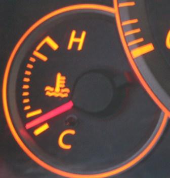

i have emanage which is reading my water temp @~100c, and my stock gauge is reading normal water temp and its not switching the fans on!
isnt 100c kinda high?
i switched my A/C on and lowered my water temp to ~80c my water gauge was reading as shown in the pict below

100C = 212F. It seems a little high, but depends on your driving. My fans came on at 218F. Not sure what my weak-*** factory gage looked like at 218F. Yours looks a little off for 176F (80C), but that's below normal operating temperature anyway. What does it look like at 195F? That's about what the thermostat controls at, right?
