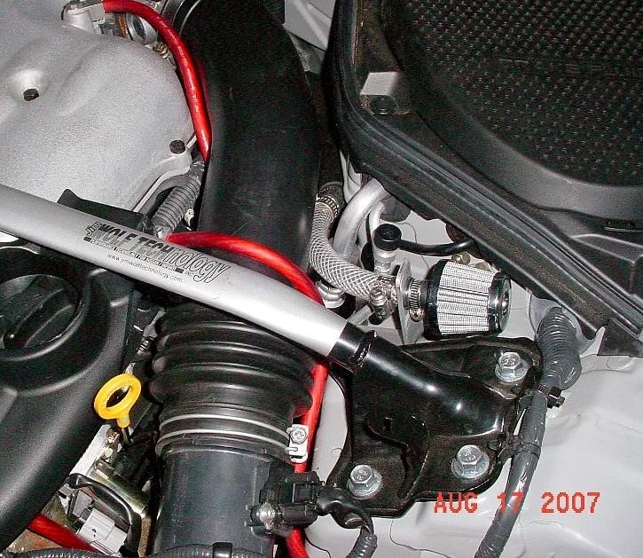

1. Yes you can, as long as it fits on the d/s valve cover nipple. I may have used 5/8ths though, I forget. The size is not important as long as it fits and can be clamped tight.
2. Heres a pic of mine. This has been in place for like 6 months and as you can see no oil on the filter and none around it. If you are pushing oil out the breather you have issues.

I've been running this for over a year. Works great. No oil in my engine bay either.
